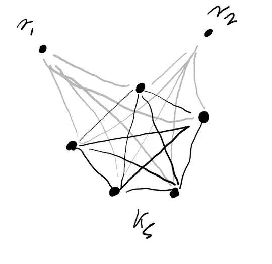

I am pretty sure the answer is again NO. And it can be seen with the same graph as in the previous question here.
Consider the graph consisting of a $K_5$ (the fully connected graph with 5 nodes) and two additional nodes $r_1, r_2$ that have an edge to each of the nodes in the $K_5$.
counter example graph
First note that if we force any of the nodes $r_1, r_2$ to take value $0$ in any of the LP formulations all the nodes in $K_5$ have to take value $1$ in order to cover all the edges from $K_5$ to the respective $r_1, r_2$. Thus an optimal LP solution would at least take value $5$. Furthermore if we force any of the nodes in $K_5$ to take value $0$ then all the other nodes have to take value $1$, as each node in $K_5$ is connected to all other nodes and these edges have to be covered. Thus an optimal LP solution would at least take value $6$.
As was shown in the original answer the first optimal LP solution we find gives all nodes value $\frac{1}{2}$. As seen above step 2 will not add any additional constraints and step 3 will not remove anything. Then the constraints added in step 4 are exactly the ones from the previous question.
So as shown in the original answer the next optimal solution found will assign all nodes value $\frac{2}{3}$. Again with the argument from above step 2 and 3 will not do anything. Now step 4 will add constraints that will force all cycles of length $3$ to take at least value $3$.
As each node is contained in a cycle of length $3$ this implies that the next solution found has to take all vertices with value $1$. Now forcing any of the nodes to value $0$ will make the solution illegal, as the respective new cycle constraints are violated. Thus the algorithm terminates with a solution that has value $7$, where the optimal solution would be $5$.
