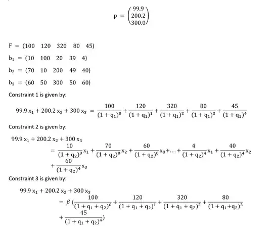

I have illustrated this using numerical data in the attached image (in case if the maths above is written incorrectly) enter image description here

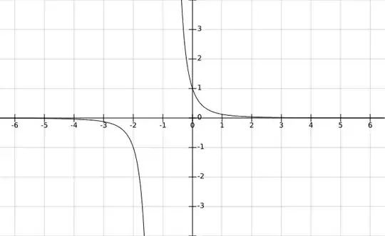

As far as I can see there is no exact convex reformulation for this, unless someone else can think of a nice trick. Constraint 1 can actually be convexified for certain ranges of $q_i$ as these functions are partially convex, e.g. $1/(1+x)^3$ is:
The fractions in constraint 3 are also convex past certain hyperplanes. However, you would have to restrict your feasible region quite significantly to impose that, which means missing out on solutions.
Constraint 2 unfortunately can not be convexified because of the multiplication by $x_i$.

  • Thank you @prubin. Your assumptions regarding sign of the parameters are correct. The part I am stuck with is constraint (3) even if try a more simplified version of the problem. E.g. assume that $q_1$ is fixed as zero, so objective is just to maximize $q_2$ and we get rid of constraint (1). The simplified problem is given by: $\max\ q_2 $ $\qquad \sum_{i=1}^{n} p_{i} x_{i} = \sum_{t=0}^{T}\sum_{i=1}^{n} \frac{b_{i}^{t} x_{i}}{\left ( 1+q_{2} \right )^{t}} \qquad \qquad(2)$ $\qquad \sum_{i=1}^{n} p_{i} x_{i} = \beta \sum_{t=0}^{T} \frac{F_{t}}{(1+ q_{2})^{t}} \qquad \qquad(3)$ – Marry Jan 29 '21 at 19:37
  • If $q_1$ is fixed, you do not need to maximize $q_2$. There is at most one value of $q_2$ that will work for a given value of $q_1$; you just need to solve for it. – prubin Jan 30 '21 at 17:07
  • For your example above with $\beta = 1.01866$ I get $q_1 = 5.450373$, $q_2 = 0.4664311$, $x = (1, 0.1334608, 0)$ and objective value $5.916804$. There's a little rounding error in there. The LHS of the three constraints evaluates to $126.6189$ and the RHSes evaluate to $126.6186$, $126.6188$ and $126.6186$. – prubin Jan 31 '21 at 00:01
