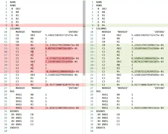

As others have pointed out already, you are not solving the same instances. When writing out the MPS files using a gurobi.env file containing GURO_PAR_DUMP=1, we can see that the instances differ (here n=2, nIters=1; left is cvxpy, right is Gurobi):
first diff
To get the signs in order, you could change this line in the Gurobi method
model.addConstr(constrLHS >= theta * IDCG)
to
model.addConstr(-constrLHS <= -theta * IDCG)
Apparently, cvxpy changes this internally. This still leaves the variable order different in both models. I didn't manage to get this identical for both codes. I did verify that the only difference is in the ordering - the objective values coincide.
That Gurobi takes more time in some configurations (especially when the instance size is larger) is probably due to the fact that you are constructing a new model every time (you should reuse the environment, by the way). In cvxpy on the other hand, the model structure is only constructed once and then reused for all instances. This also doesn't require creating a new set of variables every time. I am not sure how this is handled internally, though, since at some point the model data needs to be handed over to Gurobi.
