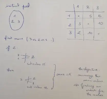

Suppose that I have a pool with N nodes and I have to move the nodes one by one to another pool. For each move, consider a value on the edge linking the two pools. The goal is to find a order of nodes (for the N nodes) that minimizes the overall cut weights between the two pools.
Is this considered a scheduling problem? If so what kind of scheduling problem?
Is it NP-complete or NP-hard?
Here is a pictorial explanation of the problem:
fathese
  • 423
  • How does the order matter ? – Kuifje Oct 26 '20 at 08:52
  • Sorry but i focus on mimimizing the maximum cut weight while moving, the nodes in each pool are linked. ie if i have moved( 1 and 3 )and 2 and 4 remains in the original pool will not have the same link weight as i have moved( 2 and 3 ) for example. – fathese Oct 26 '20 at 08:58
  • I added an image in my question to explain my problem. please refer to it – fathese Oct 26 '20 at 09:56

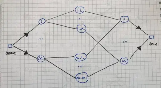

If only a subset of nodes is to be transfered, and that the cardinality of this subset is undefined, then I agree with @LocalSolver. Otherwise (if all nodes have to be transfered $1$ by $1$), I believe the problem is not NP-hard (nor NP-complete):
Consider the following graph :
  1. Create a first layer with the $n$ nodes.
  2. Create a second layer with $n \times n$ nodes : $1.1, 1.2, ...,1.n,...,n.1,n.2, n.n$. Link node $i$ to $i.1,...,i.n$ forall $i=1,...,n$.
  3. Create a third layer with $n$ nodes. Link nodes $i.j$ from layer $2$ to node $j$ from layer $3$, forall $i=1,...,n$, $j=1,...,n$.
  4. Create a source node linked to layer $1$ and a sink node linked to layer $3$. Each of these edges have a flow that must equal exactly $1$.
The graph is illustrated bellow:
Now, a flow in this graph is a feasible solution of your problem (if my understanding is correct). Layer $2$ will give you the order of the transfers. For example, if edge $(1,1.3)$ is used, node $1$ will be transfered in 3rd position. The third layer ensures there is exactly $1$ node that is transfered per iteration.
To have the cheapest solution, add the cost of the cut on the edges linking layers $1$ and $2$.
Therefore your problem is not NP-complete, nor NP-hard, as flow problems can be solved in polynomial time.

  • Maybe I am overseeing something obvious, but how exactly do I choose the weights for the edges in order to minimize the maximal occurring cut? – SimonT Nov 24 '20 at 11:16
  • I may have misunderstood, but OP states that "for each move, consider a given value on the edge linking the two pools." So the weights are given (?). Also, it we want to know if it is NP-complete, we can leave out the weights as we are only interested in the decision version of the problem. – Kuifje Nov 24 '20 at 13:02
  • From my understanding the image in the OP question states that we are want to find find the order in which to move the nodes such that the maximal cut occurring between the two pools is minimized. – SimonT Nov 24 '20 at 13:07
  • For NP-completeness, minimization is not relevant. And for the weights, I believe they are given. Maybe OP can clarify, because the problem is exclusively NP-hard, or not... – Kuifje Nov 24 '20 at 13:10
  • In order to be able to say whether it is NP complete or not it needs to be in NP and thus a decision problem. The way it is stated by OP it is a minimisation problem. For me the logical corresponding problem in NP would be the one: Is there a solution such that the maximal cut is smaller than $k$ for a given $k$. – SimonT Nov 24 '20 at 13:15

  • The question is not $100%$ clear, but it seems all nodes have to be transfered one by one. In this case I don't think it is a parititioning problem. Otherwise I agree with you! – Kuifje Oct 26 '20 at 09:44
  • I added an image in my question to explain my problem. please refer to it – fathese Oct 26 '20 at 09:57
  • the objective is to find a vertices order so i think it is a scheduling problem rather than graph partitioning problem – fathese Oct 26 '20 at 11:03
