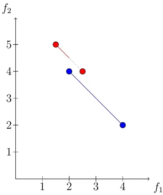

No. You cannot be sure to find all Pareto optimal solutions to a MILP using the weighted sum approach. You are not even guaranteed to find all non-dominated outcomes. You are only guaranteed to be able to generate the supported non-dominated solutions. All the unsupported non-dominated solutions cannot be found using the weighted sum approach (without adding additional constraints). This is all due to the fact that it is not enough that the objective functions are convex, also the decision space needs to be convex for the weighted sum approach to guarantee all non-dominated outcomes.
Consider the following small bi-objective MILP example: \begin{align} \min\ & 4 + 2x_1+x_2+\frac{1}{2}y\\ \min\ & 2+x_1+2x_2+3y\\ \mbox{s.t.:}\ & x_1+x_2+y\geq 2\\ \ & x_1,x_2\geq 0\\ \ & y\in\{0,1\} \end{align} The non-dominate solutions can be illustrated as follows: Non-dominated frontier
The red line (solid and dotted) is the efficient front for $y=1$ and the blue solid line is the efficient front for $y=0$. Hence, the set of non-dominated outcomes is given by the union of the two solid lines. However, it is only the top left red dot and everything one the blue line you can find using the weighted sum scalarization. You can find the top red point using weights $(0.9,0.1)$, the middel blue point using weights $(0.6,0.4)$, and the lower right blue point using weights $(0.1,0.9)$.
Thus, you cannot generate the entire set of non-dominated outcomes for MILP problems in general using the weighted sum scalarization.

  • Thanks Sune for your answer. I have difficulties understand it and I have follow up questions. 1)What are supported and unsupported solutions (never heard about this)? 2) Why is the lower red point pareto-efficient? The upper blue point has better objective values and (pareto) dominates it. So there is no need of finding it. The weighted sum approach does not need to find it because it is not pareto-efficient. Thus the weighted sum approach in your example can in fact find all pareto-efficient solutions as far as I understood – PeterBe Oct 09 '20 at 14:18
  • Supported solutions are those solutions that produce outcome vectors lying on the boundary of the convex hull of the set of non-dominated outcomes. That is, loosely speaking, those that maps to the lower envelope of the feasible space in outcome space. 2) the lower red point is non dominated for the sub problem where $y=1$. But it is not non-dominated for the MILP. However, everything on the solid red line is non-dominated and cannot be found using a weighted sum approach.

  • Thanks Sune for your answer and effort. Still I do not understand why it is an disadvantage when not being able to find the lower red point. For me this solution is dominated and I do not need it at all. – PeterBe Oct 12 '20 at 08:13
    It is not the lower red point that is the problem. It is all the points on the solid red line! Those points on the solid red line are non-dominated and they are unsupported. Thus, you cannot find them using the weighted sum approach. The only points you can find using a weighted sum approach is the two blue points, the points on the line between them, and the upper left red point. But, you cannot access the points on the solid red line using a weighted sum approach. – Sune Oct 12 '20 at 09:05

  • In https://pubsonline.informs.org/doi/pdf/10.1287/ijoc.2019.0887, there's a very nice illustration of what happens to the efficient frontier when you have bi-objective MILPs (Figure 1). The effieicnet front becomes the union of closed line segments, half open line segments, open line segments, and isolated points. The large majority of the non-dominated points in Figure 1 of the paper are unsupported, and only a few extreme points of subproblems are supported and thus possible to find using a weighted sum approach, contradictig @LarrySnyder610 's comment to the original question a bit. – Sune Oct 12 '20 at 09:43

  • Hi Sune, it's me again having a question to your answer after a long period of time :-). You mentioned that the weigthed sum approach can't find the red straight line. Can you explain, why this is the case? Further, I don't understand in your answer why you distinguish between y=0 and y=1? Actually I want to have all non-dominated solutions and it should not matter which value y has. The number of non-dominated solutions should be found for the whole problem and not the separate sub-problems (y=1, y=0). – PeterBe Feb 28 '23 at 02:02
