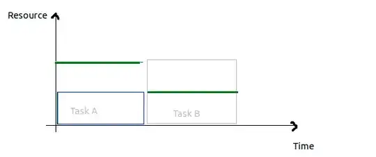

However, I want to find a way to somehow deal with this "infeasibility"case. enter image description here
Remark: the green lines are the availabilities of the resource, Task A in blue is scheduled and task B in grey is not scheduled because it requires two units wheras only 1 unit is available.
If the task A is scheduled first (because it has the highest priority), there will be not enough resource for the task B. Thus, by the end, not all the tasks are scheduled (task B is not scheduled). However if I've scheduled B first, it will be o.k, since task A requires only one unit, and by the end all the tasks will be scheduled.

I'm not sure there is a way to tweak your heuristic that will guarantee finding a feasible solution (assuming one exists). What you might try is a restart approach combined with a modification of your priority assignment method. Let's say that the modified heuristic assigns each task a "base" priority and then adjusts it when computing priorities for group B tasks. If the heuristic finds itself blocked as in your diagram, it increases by some specified amount the base priority of the task that cannot be scheduled (and maybe increases the base priorities of predecessor tasks as well), then scraps the schedule under construction and starts over.
prubin
  • 39,078
  • 37
  • 104
  • How to decide about the quantity of adjustment, if a task is unscheduled do I need to guarantee that its priority is higher than any other task? 1. Can a time analysis (i.e compute the earliest and latest start time for each task) be helpful to remove some of the blocking cases ? 2. Assuming I do this and still have some unscheduled tasks. When I do a local search, how to consider those unscheduled tasks ?
