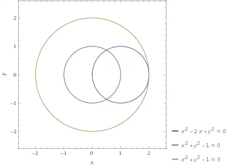

Example: Consider two ellipses, given by $A_1 = I$, $B_1 = (-1, 0)^\top$, $C_1 = 0$ (blue circle), and $A_2 = I$, $B_1 = 0$, $C_2 = -1$ (red circle)
Ellipse example
The dual is given by $$\begin{align} \max_{V, \lambda} &\quad V\\ \text{s.t.} &\quad \begin{bmatrix} \lambda A_1 - A_2 & \lambda B_1 - B_2 \\ (\lambda B_1 - B_2)^\top & \lambda C_1 - C_2 - V \end{bmatrix} \succeq 0 \\ ~&~\lambda \ge 0.\end{align}$$
Solving this SDP yields the solution $V = -3$ and $\bar{\lambda} = 2$. As $V < 0$, there exists an $X \in \mathcal{E}_1 \setminus \mathcal{E}_2$.
If we use the first of the optimality conditions, we have $$-\nabla g_2(X) + \bar{\lambda} \nabla g_1(X) = 2 (\bar{\lambda} A_1 - A_2)X + 2(\bar{\lambda} B_1 - B_2) = 2IX - (-4, 0)^\top = 0,$$ which solves for $\bar{X} = (2,0)^\top$. It is easy to check that the other conditions are also satisfied, which means that $\bar{X}$ is a primal optimal solution. Indeed, $\bar{X} \in \mathcal{E}_1 \setminus \mathcal{E}_2$.
In the picture, the yellow circle corresponds to the ellipse $g_2(X) = -V$. This ellipse intersects $\mathcal{E}_1$ at the maximum (weighted) distance from the center of $\mathcal{E}_2$. Their intersection is exactly the point $\bar{X}$.
