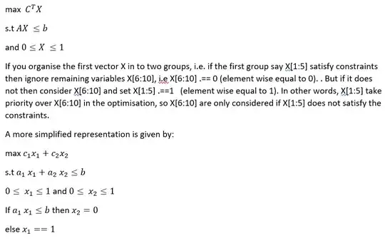

Assume that the problem is given by: enter image description here

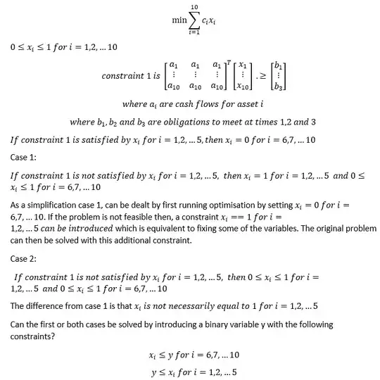

For a more detailed example, assume that you have certain obligation at times 1, 2 and 3. You have 10 assets. First you want to see if you can meet the obligations by the first 5 assets before considering the remaining 5. The objective is to find the minimum amount of asset that you can invest in to meet the obligations. enter image description here

It sounds like you want to enforce the following logical proposition: $$\bigvee_{i=6}^{10} (x_i>0) \implies \bigwedge_{j=1}^{5} (x_j=1)$$
You can model this by introducing a binary variable $y$ and linear constraints: \begin{align} x_i &\le y&&\text{for $i\in\{6,\dots,10\}$}\\ y&\le x_j &&\text{for $j\in\{1,\dots,5\}$}\\ \end{align}

The answer to the first part is yes, provided that you are using a solver that supports indicator constraints. As far as I know, there is no "standard" notation for it. Something like $$a_1 x_1 \le b \implies x_2 = 0$$would seem reasonable to me. The "else" part is tricky, since it deals with the case $a_1 x_1 > b$ and strict inequalities are a no-no. You could approximate it by $$a_1 x_1 \ge b + \epsilon \implies x_1 = (1,\dots,1)^\prime$$where $\epsilon > 0$ is some small tolerance value. Note that this would make any solution with $b < a_1 x_1 < b + \epsilon$ infeasible.
A big-M formulation for the simplified version might look like the following, where $y\in\lbrace 0, 1\rbrace$ is a new binary variable, $M_1$ is a valid upper bound on $a_1x_1$ and $M_2$ is a valid upper bound on $b+\epsilon - a_1x_1$: \begin{equation*} a_1 x_1 + a_2 x_2 \le b \\ a_1 x_1 \le b + M_1y \\ a_1 x_1 \ge b + \epsilon - M_2(1-y) \\ x_2 \le y \\ x_1 \ge y \\ 0 \le x_1, x_2 \le 1. \end{equation*} There is one important catch here. This only works if $a_1 \ge b+\epsilon$.

  • Thank you for your answer. I have provided a more detailed example in the question. Does your solution still hold? – Sam Apr 12 '20 at 10:06
  • Not for case 2. I'm not sure if it can be fixed for case 1, but it's probably not worth it. There could be a problem if the second tier variables are much cheaper than the first tier variables. It's much easier (and arguably safer) to solve a restricted LP (second tier variables locked at zero) and then solve the full problem only if the restricted problem is infeasible. – prubin Apr 13 '20 at 15:59
