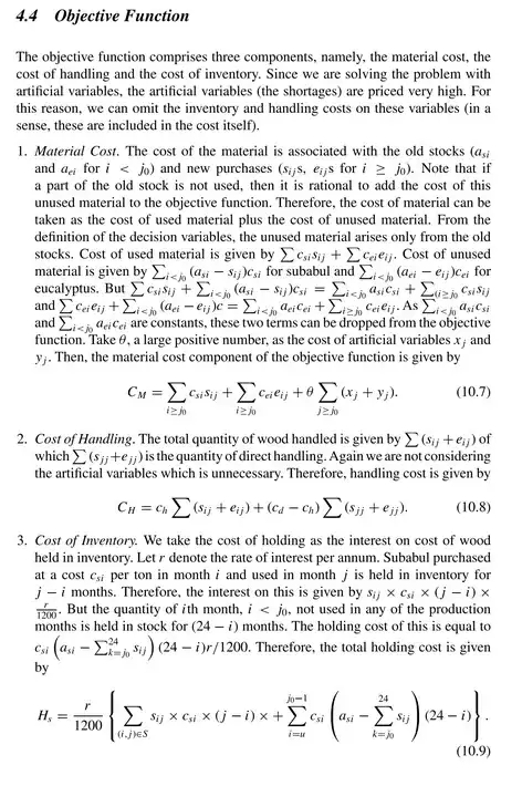

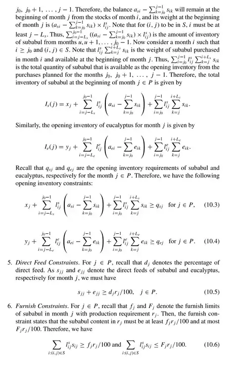

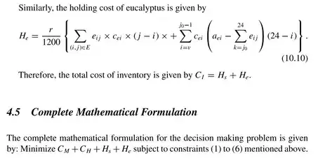

I need to solve This Problem using Simplex, Dual Simplex, Big M and 2 Phase. I can use a solver for this problem, but I don't know how to start.
In the PDF above it looks like it has all the constraints and the objective function, I assume I will have to substitute the above values and make a massive objective function. But I don't know what I even need to do.
I have downloaded GAMS and modeled a simple problem in it, but I am not understanding how to start modelling this one in it. So can someone help me on how to start? I have not solved these types of problems before, so which program should I use? Any tutorials maybe on how to model my problem in it.
Other than GAMS I checked and their is an Excel Solver, some libraries for python. I am fine with any of these.
Adding a few images from the PDF:
Cons Cons1 Objective Objective 2

  • @A.Omidi I solved a simple problem in Gams, like the first image I have sent. But I can't understand how to model this problem with summation equations. Plus there are 5 objective functions, which I don't understand how to handle that. I saw the other post that Mostafa sent and I am understanding a bit. I am guessing I will have to simplify my objective function before trying anything but. – HABIL BHAGAT Apr 02 '20 at 08:24
  • @Habil, as per your previous question, by using a solver like Gurobi or Cplex, trough an API or framework, it does automatically and you do not need to perform it yourself. (I mean simplex or dual simplex.). About the big M or two phases and based on your problem formulation you will have to do that yourself. Would you please, do you see the transportation problem coding in GAMS as I said in the previous comment? If you are new in the MP or programming and you would need to use an MP solver, I really recommended you to use an algebraic modelling language like GAMS. – A.Omidi Apr 02 '20 at 13:29
  • Ah, about your multi-objective problem, first you will need to formulate and write the problem in your favourite framework/API, then by using some methods like the sum of weighted objects, lexicograph and etc, you can solve the problem. Would you try writing your problem in GAMS? – A.Omidi Apr 02 '20 at 13:48
