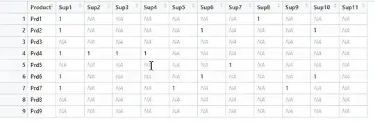

I have the following matrix of suppliers who are able to make a certain product, against all products in my portfolio.
What is the best way of finding the solution to "the least suppliers necessary to deliver the whole portfolio" - and "which suppliers are necessary to deliver the whole portfolio"?
Ideally looking for a solution in R, since I have manipulated the data beforehand in order to get to this one-hot coded matrix. But generally I'm trying to understand first how to approach this.
The full dataset is obviously larger - I can see myself that in this case only Sup1 and Sup7 would be required :-)
I received some great answers below. Unfortunately I cannot install the "pulp" module for python on my laptop (restrictions from work - I know it doesn't seem to make sense). I am trying to convert the below python script into R (ompr by @dirks user:2798441). However I struggle with the syntax. I receive an error message with below code:

test <-rbind(c(),
           c("Prd1", 1, NA, NA, NA, NA, NA, NA, 1, NA, NA, NA),
           c("Prd2",1, NA, NA, NA, NA, 1, NA, NA, NA, 1, NA),
           c("Prd3",NA, NA, NA, NA, NA, NA, NA, NA, NA, NA, NA),
           c("Prd4",1, 1, 1, 1, NA, NA, NA, NA, NA, NA, NA),
           c("Prd5",NA, NA, NA, NA, NA, NA, 1, NA, NA, NA, NA),
           c("Prd6",1, NA, NA, NA, NA, 1, NA, NA, NA, 1, NA),
           c("Prd7",1, NA, NA, NA, 1, NA, NA, NA, 1, NA, NA),
           c("Prd8",NA, NA, NA, NA, NA, NA, NA, NA, NA, NA, NA),
           c("Prd9",NA, NA, NA, NA, NA, NA, NA, NA, NA, NA, NA))
dims <- dim(test)
test <- as.numeric(test)
dim(test) <- dims
test.df <- data.frame(test)
colnames(test.df) <- c("Product","Sup1", "Sup2", "Sup3", "Sup4", "Sup5", "Sup6", "Sup7", "Sup8", "Sup9", "Sup10", "Sup11")
test.df[,1] <- c("Prd1","Prd2","Prd3","Prd4","Prd5","Prd6","Prd7","Prd8","Prd9")
