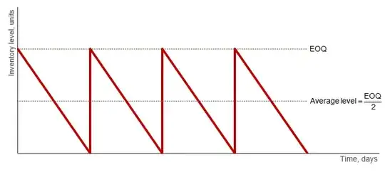

The total holding cost can be calculated as annual holding cost per item times average inventory level, which is measured in items and happens to be equal to $\frac{Q}{2}$. Usually, in textbooks they use continuous inventory depletion model, like in the picture below, and use the triangle area formula to explain the intuition.
continuous demand
However, in for more general settings the EOQ formula derivation is even less straightforward, and involves derivative and integration. To explain it in apples-to-apples manner you would have to go deep into mathematical realms, which defeats the whole purpose. I noticed that in textbooks, even the Master level ones, they drop the measurement units issue in discussion of EOQ, newsvendor model and other nonlinear topics.
