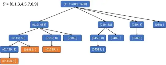

Example
Consider $D = \{0,1,3,4,5,7,8,9\}.$ We may begin the search at $X^\prime = \{0,9\}$ because $n=9$ is the range of the differences $D$ and I am normalizing the orbit representatives to begin at $0$ (rather than $1$). The initial candidate set $C$ consists of the augmentors of $X^\prime.$ These will be the integers $g$ between $0$ and $9$ (exclusive) for which both $g-0\in D$ and $9-g\in D,$ yielding $C = \{1,4,5,8\}.$ Thus the root node of the search tree is
$$(X^\prime, C) = (\{0,9\},\ \{1,4,5,8\}).$$
In the figure I have dropped the set braces and commas for brevity.
Figure
This diagram of the (pruned) tree for $\{0,1,3,4,5,7,8,9\}$ is rooted at the top. The candidates $g$ corresponding to the edges $(X^\prime;*)\to(X;*)$ can be determined by comparing $X$ to $X^\prime:$ $g$ is the new element in $X.$ Partial solution nodes are shown in blue and full solutions in orange.
This is not the full tree: it is the tree after it has been pruned during a depth-first, left-to-right search. Thus, for instance, after initially searching the candidate $g=1$ from the root in the leftmost branch, $1$ was eliminated from the candidate lists in the subsequent branches from the root.
The three solutions are, in the order found, $\{0,1,4,5,8,9\},$ $\{0,1,4,8,9\},$ and $\{0,1,5,8,9\}.$ It is noteworthy that a larger solution was found before the shorter ones. (This is not invariably the case, though.)

    Thanks for this extensive explanation and code! Your R program is much faster than my Picat program. One question, though: I am a little confused about the (tree) example of D = {0,1,3,4,5,7,8,9}. Since it is a list of difference, then the 0 should be omitted since a 0 indicates - at least in my interpretation of the problem - that there exists a duplicate in the original list (X). I get the same three solutions as your example when the 0 is omitted from D.
    You R program give the same result whether the 0 is in the list or not (though X starts with 1 not 0).
    – hakank Feb 17 '20 at 06:42
    Whenever $A$ is nonempty, $0\in\Delta(A).$ In effect, every element of a set is its own "duplicate." Thus my program assumes $0$ is the difference set whether or not you indicate that explicitly. BTW, I have been running additional timing tests. In the largest, 40 random differences in the range 0..5000 were analyzed. In such "sparse" cases, typically the program finds one solution almost instantly and then runs forever searching through the rest of the tree. Almost always there will be (at least) two solutions: the second consists of $n+1-A$ when $A$ is a solution. – whuber Feb 17 '20 at 13:20
    Thanks for the explanation. I can also confirm that a random problem instance typically has two solutions, unless A == n+1 - A, then it has a single solution.
    I'm now happy with this so I accept the solution.
    – hakank Feb 17 '20 at 17:14
