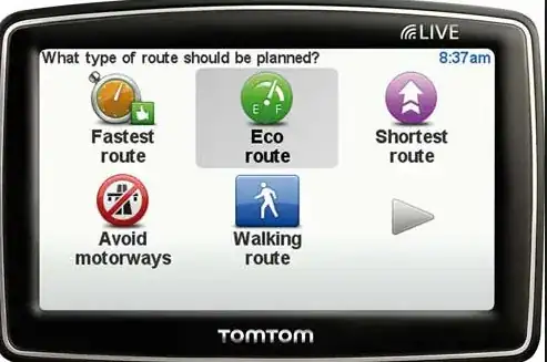

Example A simple user interface for a GPS that allows the user to change between different objectives (speed vs. fuel) and constraints (walking vs. highways) GPS

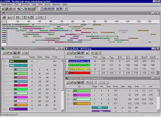

As I am interested in planning and scheduling, specifically in industries and real situation, I try representing two optimization software (Indeed, I am aware many examples could be represented by others.). One, based on academic works and the other commercial software:
  • based on academic work: LAKIN
It was developed by Prof. Michael Pinedo and his team at the Stern School of Business, NYU. It has a nice interface and using some rules and heuristics to solve the scheduling problems. It enables users to modify and adjust planning after solving the model and easily reoptimize the problem. I really enjoy it.

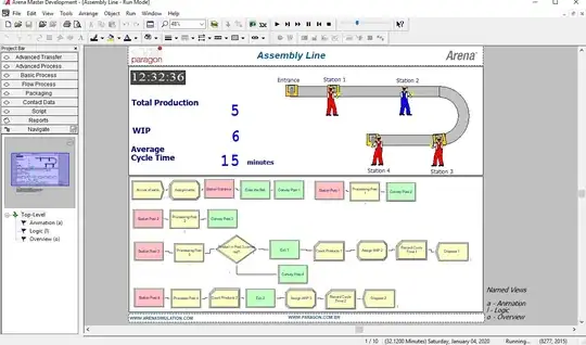

Much commercial software could be applied in practice but, I would like to represent a simulation software, ARENA. It has a flowchart interface which clients can use it easily. It has many specific features to modify and reoptimize the model.

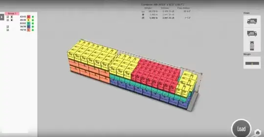

  • Thank you for the answer and especially sharing some screenshots from applications you like. I especially like that you can easily modify and re-optimize which I think is very important. Can you share some more in-depth details or an example of how this user-flow works? How many clicks and inputs do the user need to make? how long time does it usually take to re-optimize? – Michael Lindahl Jan 04 '20 at 15:59
You mentioned: "Often, a planner will not have an operations research background and the software needs to be easy and intuitive so the user (and organization)...". So, I assume by optimization software you mean software with an OR algorithm in the background for an end-user.
I include two screenshots from some searches. I got the screenshots from their videos and I have not tested any of these myself. But their videos looked to have intuitive user-interface and I don't think it's very hard for someone to get a demo of them.
  1. A container loading software that one can assume should be based on solutions of (3D) bin packing problems: enter image description here
