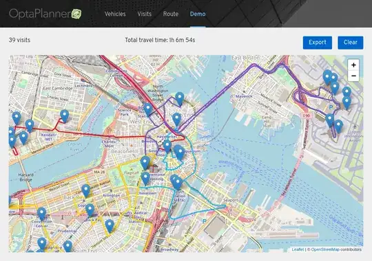

In my experience when solving Vehicle Routing with time windows in the industry, with one case handling 50 000+ vehicles and 100 000+ visits per day as well as many other cases with lower numbers, all running in production, I notice that:
  • The problem is often (un)naturally partitioned, due to Conway's law. In the 50K+ vehicles case, each vehicle and visit is confined to a region, so each region is a partition. The size of the regions varies (sometimes it's a US state), but if I recall correctly the partitions went up to around 1k vehicles.
  • At some point, depending on the solver, partitioning increases solution quality given a fixed time limit. This is a sign of weakness that every solver will run into when scaling VRP. The question is not if, but when. Note you can first solve partitions and then warm start a global solver on the merging of the resulting partitioned solutions, which sometimes leads to better results.
  • Multi-threaded solving (our moveThreadCount) and nearby selection make a world of difference. Our OptaPlanner got scores in minutes what OR-Tools and 2 other competitors took hours to do, in the customer's extensive benchmarks consistently across multiple rounds. Your mileage may vary. Tuning matters.
  • Management was expecting a 1-2% improvement in driving time reduction. It was 25%, to their surprise. This resulted in huge (CEO level) savings and a reduction of 10 000 000+ kg of CO² fuel emissions per year.
    • Even multi-bet solving (AKA multi-walks) is worth the extra hardware costs.
  • Night planning (batch planning) != day planning (real-time planning as the problem changes). Both deliver huge benefits. Start with a Minimum Viable Product that only does nightly planning, that's easier to implement.
  • Do not use air distances. Use actual road times (= distance matrix). In my experiments, optimizations on air distances are easily 4% off compared to real road distances on my test Belgium datasets which have very dense road networks (so others countries will be much worse).
  • Distances matrix are tricky. A distance matrix of 10 000 visits takes 1.6 GB RAM memory in it's most efficient form (it doesn't matter if it's Java, C++, Python, etc). That's without traffic data. When the number of visits double, the RAM reqs quadruple.
  • Good demo's matter too. Decision makers rejected our Java Swing demo's, so we recently we build a dedicated open source webapp to demo VRP:

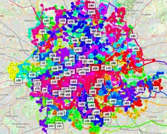

I make a commercial vehicle routing solver for both dynamic and static problems (see https://odllive.com), and so I can offer a bit of industry insight into this question.
Using heuristics, metaheuristics including things like clever splitting of the problem, you can get to much larger problem sizes. This doesn't mean of-course that you're getting optimal solutions for these larger problem sizes, but you are getting 'good enough' solutions to be workable in real-life. For example, we have a 'fuzzy splitting' algorithm within our ODL Live engine that lets us get reasonable solutions in a reasonable timeframe for 5000 delivery problems, as shown in the following screenshot:
5000 delivery vehicle routing problem
Although I've no doubt there's other commercial solvers which can get to this size of problem, 5000 appears to be on the large size for most. For example, as of September 2020 a popular solver called Routific appears to have an upper limit of 2000 deliveries - see https://dev.routific.com/pricing
Interestingly enough once you get to these size of problems, creating and holding the distance and travel time matrix in-memory can also become a bottleneck. Academic works using large problems tend to just assume Euclidean (i.e. straight line) distances between points which they can just calculate on-demand, so they don't tend to hit this issue. In-reality you need to be doing calculations based on the road network, with adjustments for rush hours etc. This adds significant overhead in both matrix calculation time and memory storage space.
It's also worth mentioning that what you would assume to be the really large problems encountered in industry - i.e. parcel delivery problems - are actually commonly split up into really small problems instead, as for high density parcel delivery operations often each driver has their own fixed territory. So you may have (for example) someone like DHL or UPS delivering tens or hundreds of thousands of items within a large city, but these could all be independent single-vehicle problems with perhaps 100 stops per vehicle. This is common because fixed driver territories makes sortation at the depots more efficient, and allows drivers to build up local knowledge (i.e. best places to park) which helps them complete their route quicker. Presumably this offsets to some extent the loss of efficiency through treating as isolated subproblems.
