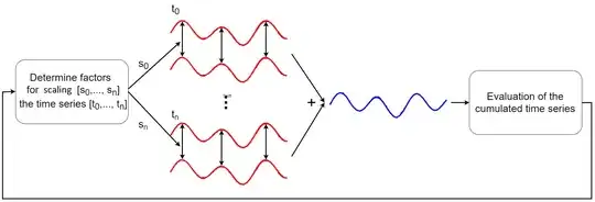

Currently, I am working on a relatively simple optimization problem:
There is a set of time series (red) that get summed up to a cumulated time series (blue). The red time series have different forms (simplified here).
During the optimization process, I want to scale the time series up or down so that my optimization solution is a set of $n$ factors for scaled the individual time series.
It applies: $\boldsymbol y = \sum\limits_{i=1}^{n}(\boldsymbol x_i \cdot s_i)$, where the $\boldsymbol x_i$ are the individual time series and $\pmb y$ is the cumulated time series. The factors are not allowed to be negative and together they must add up to $1$.
The function for evaluating the cumulated time series calculates the MSE between the cumulated time series $\boldsymbol y$ and another time series $\boldsymbol z$: $$\text{MSE} = \frac{1}{m}\sum_{i = 1}^{m}{(z_i - y_i)^2}.$$
For my first tests, I used the heuristic Simulated Annealing to set the factors iteratively. This works, however, it seems to be a bit oversized for this problem, because it has only one minimum.
How would you solve this problem?
