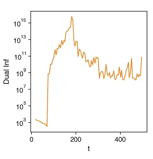

As the question says, I am wondering what happens "behind the scene" when the Dual Infeasibility column of the Gurobi runtime log oscillates wildly, before Gurobi eventually quits with infeasibility. I am solving a mixed-integer model. More specifically, all integer variables are binary. An example plot of Dual Inf is below (value of Dual Inf. versus clock time). I am hoping this could point to some problems in my model formulation.
Value of dual infeasibility versus solver clock time

  • You are looking at the root node relaxation of your MIP, so the all integer or binary variables are treated as continuous variables. If this relaxation is already infeasible, the corresponding MIP needs not to be processed. So you are looking here at a pure linear programming problem. – mattmilten Nov 15 '19 at 11:52

I think the oscillation that was shown in the plot is related to one of those points with the star in the log file.
