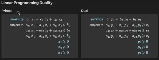

I was having the same problem: I always had to look up the rules for taking LP duals. So I've built a small web page at https://lpdual.com that quickly gives the answer. It shows a sample primal program, and allows you to change the sense of the constraints and variables and to then see the effect on the dual.
Screenshot
    How is this going to help someone $remember$ the rules for taking a dual? This is just a tool which dualizes an LP for you but it does not make me remember the rules. – YukiJ Jan 18 '22 at 07:19
    @YukiJ For someone learning the rules, it provides a way to practice on new problems and confirm that their answers are correct. – prubin Jan 18 '22 at 16:21
