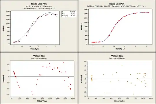

  • "What Is the Difference between Linear and Nonlinear Equations in Regression Analysis?"
    Compare a linear versus a nonlinear regression model of the relationship between density and electron mobility. The nonlinear equation is so long it that it doesn't fit on the graph:
    $$\Tiny{\begin{align} \text{Linear equation (left side)} & \qquad \qquad \qquad \qquad \\ \text{Mobility } = & \text{ } 1243 + 412.3 \times \text{Density Ln} - 94.29 \times \text{Density Ln}^2 - 32.90 \times \text{Density Ln}^3 \qquad \quad \\ & \\ \text{Non-linear equation (right side)} & \\ \text{Mobility } = & (1288.14 + 1491.08 \times \text{Density Ln} + 583.238 \times \text{Density Ln}^2 + 75.4167 \times \text{Density Ln}^3) / (1 + 0.966295 \times \text{Density Ln} + 0.397973 \times \text{Density Ln}^2 + 0.0497273 \times \text{Density Ln}^3) \quad \\ \end{align}}$$
Linear versus Non-linear
On the left:
"The fitted line plot shows that the raw data follow a nice tight function and the R-squared is 98.5%, which looks pretty good. However, look closer and the regression line systematically over and under-predicts the data at different points in the curve. When you check the residuals plots (which you always do, right?), you see patterns in the Residuals versus Fits plot, rather than the randomness that you want to see. This indicates a bad fit, but it’s the best that linear regression can do.".
On the right:
"The fitted line plot shows that the regression line follows the data almost exactly -- there are no systematic deviations. It’s impossible to calculate R-squared for nonlinear regression, but the S value (roughly speaking, the average absolute distance from the data points to the regression line) improves from 72.4 (linear) to just 13.7 for nonlinear regression. You want a lower S value because it means the data points are closer to the fit line. What's more, the Residual versus Fits plot shows the randomness that you want to see. It’s a good fit!".
