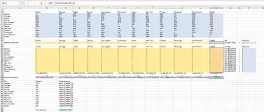

This is difficult for me to explain so I've included a screenshot of the Excel model I am trying to scale-up using Python. The "Logical constraint" is what I am trying to code into Python:
