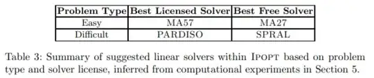

This question happened to appear only a couple days after Byron Tasseff, Carleton Coffrin, Andreas Wächter, and Carl Laird (the last two are the original authors of IPOPT together with Larry Biegler) uploaded the following paper in arXiV.
The paper compares the different Linear Solvers (and potential parallelization schemes) performance within IPOPT. They perform a really thorough computational comparison using both CUTEr instances and other more challenging cases. I will just include the last table in the manuscript here:
Taken from [1]
