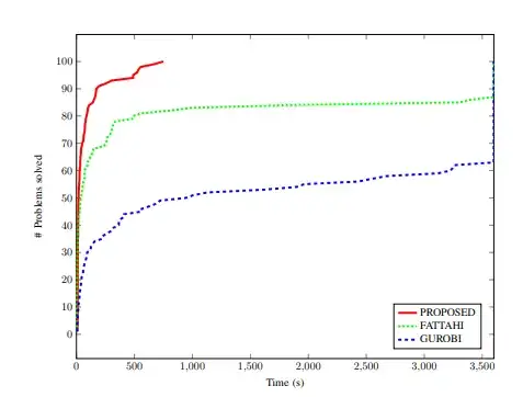

I'm currently working on the optimal transmission problem (OTS), that is a particular optimization problem that is originally formulated as a mixed-integer non-linear problem and usually reformulated as a mixed-integer linear optimization problem that requires bigMs. I show below a summary of the results for 100 random instances of this problem. This plot compares three methods:
  1. Gurobi: just solving the OTS problem as a mixed-integer non-linear problem that includes the product of binary and continuous variables. This method does not require bigMs.
  2. Fattahi: Formulate the OTS as a mixed-integer linear problem with bigM that are tuned as proposed in https://ieeexplore.ieee.org/document/8451930
  3. Proposed: The method we propose to find better bigMs in this preprint (https://arxiv.org/abs/2306.02784)
As you can see, methods 1) and 2) are unable to solve the 100 instances to optimality within a maximum time of 1 hour, while our method can solve all problems in a maximum time of 800 seconds.
I also implemented the indicator function in Gurobi, although I did not include it in the figure because the results are worse than the mixed-integer non-linear solutions provided by Gurobi. In fact, this approach does not solve any of the 100 instances in 1 hour. The average gap is 6.91% and the maximum gap amounts to 12.51%. Then, even though I am not sure what Gurobi is doing "behind the scenes" with this indicator constraints, its computational performance is questionable.
Conclusion: I agree with other opinions here and, in my experience, using information about the problem to properly tune bigMs normally provides better computational results than using general purpose methods implemented in commercial optimization solvers such as CPLEX or Gurobi.
