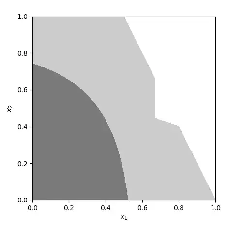

Toy Example
Suppose we have the constraint $$ \Pr[\xi_1x_1+\xi_2x_2\leq2]\geq0.9. $$ where $x_1$ and $x_2$ are non-negative decision variables, $\xi_1\sim\mathrm{Poisson}(1)$, and $\xi_2\sim\mathrm{Poisson}(1/2)$. The true chance constraint can be evaluated using the law of total probability (see code below). For the conservative approximation, we take $F(x,\xi)=\xi_1x_1+\xi_2x_2-2$, $\varepsilon=0.1$ and $\psi(t)=\exp(t)$. As noted above, this choice of $\psi$ is equivalent to the MGF of the random variable $\xi_1x_1+\xi_2x_2-2$, which is given by $$ \exp\big[\lambda_1(e^{x_1/t}-1)+\lambda_2(e^{x_2/t}-1)-2/t\big] $$ where $\lambda_1=1$ and $\lambda_2=1/2$. Hence, for any $t>0$, the following is a conservative approximation: $$ t\cdot\exp\big[(e^{x_1/t}-1)+\tfrac{1}{2}(e^{x_2/t}-1)-2/t\big]\leq{t\varepsilon} $$ An example of the true feasible region (light gray), and the approximation for $t=0.4$ (dark gray) are shown here:
example of a conservative approximation
Python code to produce this plot:

def main(): l1, l2 = 1.0, 0.5 tau = 2. # Chance constraint rhs eps = 0.1 # Chance risk tolerance tee = 0.4 # Conservatism a parameter num_points = 500 X = np.linspace(0, 1, num_points) X, Y = np.meshgrid(X, X)
approx = tee * np.exp(
    l1 * (np.exp(X / tee) - 1) + l2 * (np.exp(Y / tee) - 1) - (tau / tee)
exact = np.vectorize(evaluate_poisson_cc)(X, Y, l1, l2, tau)
# Plot the results
ax = plt.gca()
ax.contourf(X, Y, exact,  levels=[1. - eps, 1.],  colors="k", alpha=0.2)
ax.contourf(X, Y, approx, levels=[0., tee * eps], colors="k", alpha=0.4)
ax.set_xlabel(&quot;<span class="math-container">$x_1$</span>&quot;); ax.set_ylabel(&quot;<span class="math-container">$x_2$</span>&quot;)
ax.set_aspect(&quot;equal&quot;)
plt.show()
