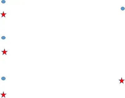

I think the issue is that the linear relaxation is in some sense more compatible with the p-median objective than the p-center problem. Consider the following example (circles are customers; stars are facilities)
Customer and Facility Locations
For the left hand customers, the distance to the closest facility is 1; for the right hand customer, the closest facility (also on the right) is 3; the distance between the left column and the right column is 6.
For p-median, everything gets assigned to their closest facility. This is true for the linear relaxation as well.
If you try to assign the right-hand customer to the left-hand facilities, it will cost 6 no matter how you assign it: it is cheaper to assign it to the right-hand facility at cost 3. Assigning fractional solutions doesn't "cheat": a good assignment will be pushed toward value 1.

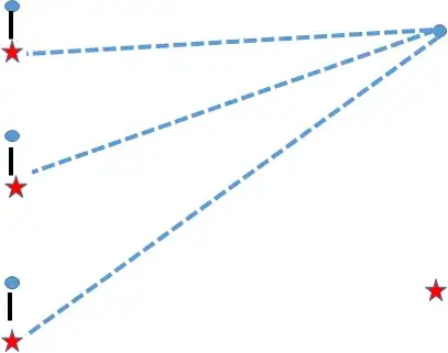

For p-center, though, there is an advantage in the linear relaxation to fractionally assign things. In our example, the best integer assignment for the right-hand-side customer is still to its closest facility at cost 3. But fractionally, there is a value to assign things to the left hand side:
If you put weight 1/3 on each of the dotted lines, then the p-center cost goes down to 2. In fact, the optimal thing to do is to is to assign weight .2 to each of the dotted lines, leaving .4 for the right hand facility, for a cost of 1.2.
Given the nasty fractional solution in this almost trivial example, it is not surprising that branch and bound has to work very hard to get to an integer solution.
