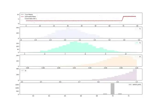

Now we get to the actual question. The arrival rates change over time hence the poisson process is not stationary. However, it is stationary for a good amount of time. So I use a Bayesian change-point model to track any changes when they have occurred. I love these models as they are really quite robust and once can tune them to account for zero-inflated data etc.
The Bayesian change-point model gives the following output for the measurement of a single lambda, lets say the arrival rate of queue 1:
The $p_i$ values are to account for zero inflation so please ignore them. Focus must turn to the arrival rates. We note that the change has left us quite uncertain about what the new rate might be (the turquoise one is a wider distribution than the purple one).
So I can take the mean of the new arrival rate, plug it into the transition probabilities and then call it a day. However, the Bayesian change point suggests otherwise. We now have the turquoise distribution being our belief distribution of $\lambda_1$. Is this model uncertainty because we are now uncertain about the transition matrix $p(x_{k+1},x_k,u)$ as a result of $\lambda_1$ not being a single scalar but a belief distribution (please excuse I have not scaled the distribution yet to be considered valid probability distributions)?
