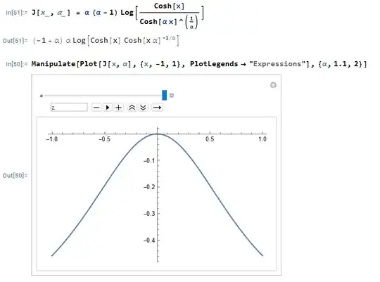

Here's a plot of the function that I made with Wolfram Mathematica: Plot of <span class=$J_\alpha(x)$ for $\alpha=2$." />

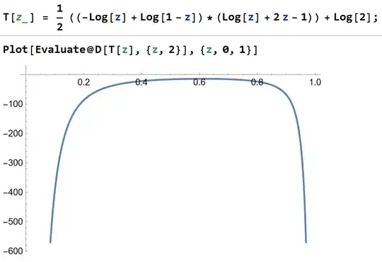

T is in fact concave, as we can see from the graph of its second derivative in Mathematica:
Plot of <span class=$T(z)$" />
