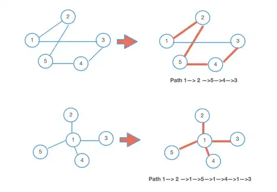

I am looking for an idea on how to formulate the following problem as a MILP. Given a connected graph, find the shortest path route starting from a node (not given) and visit all other nodes. All nodes should be visited at least once.
Some example
Enter image description here
The TSP MTZ formulation can not be used since we might need to revisit a node.

    Why might we need to revisit a node? Is the graph non-complete? – PeterD Jul 28 '23 at 08:41
  • How can you visit all nodes without visiting some nodes more than once ? – Optimization team Jul 28 '23 at 09:07
    In the TSP, all nodes are visited exactly once. – PeterD Jul 28 '23 at 10:04
  • @Optimizationteam, also the problem is similar to the multi-tsp. – A.Omidi Jul 28 '23 at 13:07
  • @Optimizationteam, for connected graphs generally, there is no guarantee that you can visit all nodes exactly once each, but there plenty of graphs, and some categories of graphs, where you can do. For example, complete graphs; or connected graphs in which no vertex has more than two edges. More generally, the set of graphs G containing subgraphs S in which all the nodes of G are nodes of S, S is connected, and no node of S is an endpoint for more than two edges is exactly the set of graphs containing a path that traverses each node exactly once. – John Bollinger Jul 28 '23 at 16:40

  • I think this is what i am looking for. Let me check if i understand it. As you got the point, this is not a classic tsp since in some graphs we might need to pass a node more than once – Optimization team Jul 29 '23 at 01:46
  • It works ! the only issue is that xijk creates too many binary variable ! also the number of required steps (k) is not predetermined and it is computationally expensive Thanks for your suggestions – Optimization team Jul 29 '23 at 03:48
