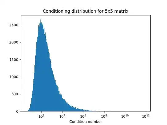

A plot of the condition number across matrices: Plot of the condition number for 5x5 matrix

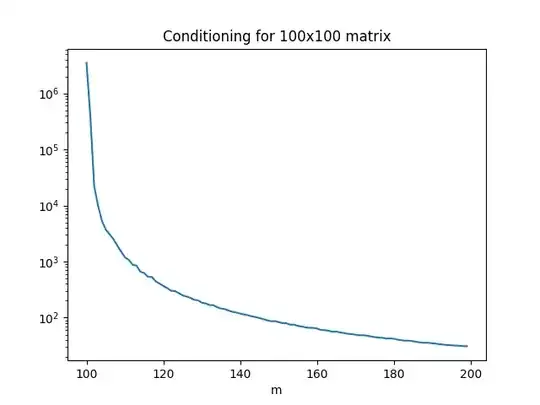

If this is indeed the issue for your solver, you could generate matrices with better eigenvalue distributions. A very simple way to improve the conditioning (flatten the eigenvalue distribution) is to make your initial matrix $H$ non-square ($n \times m$ with $m > n$).
I plotted the condition number for varying $m$, averaged over 100 matrices. We see that it improves the condition number very quickly (note the log scale!).
Please tell me if it helps with your solver.

  • Interesting. If H is n by m with m < n, $Q = HH^T$ would be at most rank m, which is less than full rank.. With m > n, Q is "super full rank", which is a term I just made up, and denotes Q being full rank, but with extra margin of being so. – Mark L. Stone Jun 19 '23 at 18:04
    Indeed, it seems that there is still a log going on after the $n = m$ threshold. I was surprised by how steep the change is – Ggouvine Jun 19 '23 at 18:25

    I just saw that your tests are for $n=5$, and it seems very early to have problems due to condition numbers too, so I plotted the conditioning of many random 5x5 matrices. It can still get bad quickly if you are unlucky, but for most of them I wouldn't expect CPLEX to fail either – Ggouvine Jun 20 '23 at 05:49
