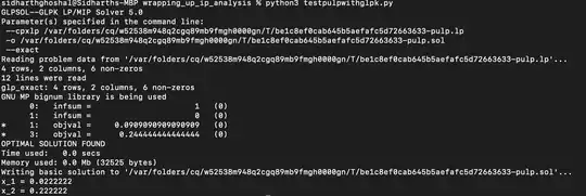

Now the next option was GLPK and I was able get GLPK working with python3 by installing
  1. brew install glpk
  2. python3 -m pip install PuLP
But while GLPK can be called via the exact flag it does not output rationals but rather a floating point representation of the exact result. See here:
And heres the code:
from fractions import Fraction
prob = pulp.LpProblem("sidsproblem", pulp.LpMaximize)
x1 = pulp.LpVariable("x_1",0,1) x2 = pulp.LpVariable("x_2",0,1)
prob += x1 + x2 prob += (5x1 + 4x2 <= 1) prob += (4x1 - 11x2 <= -1) prob += (x1 <= 0.23) prob += (x2 <= Fraction(2,9)) prob.writeLP("sidsproblem2.lp")
prob.solve(pulp.GLPK(options=['--exact']))
for v in prob.variables(): print(v.name, "=", v.varValue)
So clearly GLPK is doing exact arithmetic but the interface which talks to python3 hands python3 a float as opposed to a rational. Which defeats the point on my end.
Which now makes me wonder, what high quality WORKING implementations of exact linear programming libraries exist for python3? It seems like the options are few and limited now and I wanted to know what any of you have successfully used in the past year.
