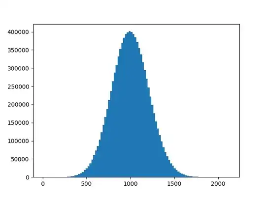

I tried simulating lots of normally distributed lead times and the normally distributed demand in each. The lead time demand sure looks normal: enter image description here
But a normality test gives $p = 0$ to at least 9 decimal places. Edit: Since the null hypothesis for this test is “the data comes from a normal distribution,” this means we can conclude the lead-time demands are not normally distributed.

  • But I'm simulating the actual lead-time demands, not an approximation of them. So doesn't that suggest that the LTD is normal, not that the normal distribution is a good approxation for it? – LarrySnyder610 Jun 10 '19 at 14:39

  • @AlbertoSantini I'm not sure I see the flaw in my way of simulating -- once we do (1), then $L$ is a constant for the purposes of generating $d$. But anyway, I also agree with your way of simulating, and furthermore, I totally misinterpreted the $p$-value, as you said. – LarrySnyder610 Jun 11 '19 at 17:54

  • Let's remove the truncation from the picture to avoid that complication. What if we allow $L$, $D$, and the LTD to be negative, i.e., we don't truncate at 0? Does that change anything? (I re-ran the simulation with that change; no change to the results, not surprisingly.) – LarrySnyder610 Jun 10 '19 at 21:15
