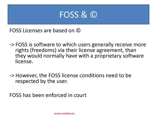

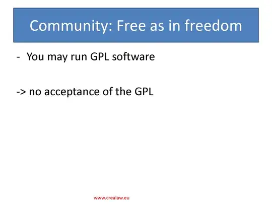

  • @RoyT. Check out this video: https://www.youtube.com/watch?v=NCwhEWEPV-E Ywein van den brande is an IP attorney and he has written and co-authored different books on the subject. – Bruno Lowagie Jan 23 '17 at 09:24
  • Could you instead provide references in your answer of quotes of this video that support your answer? We cannot ask users of this site to go offsite watching a 15-minutes long video if this contains the substance of an answer. – Philippe Ombredanne Jan 23 '17 at 09:42
  • I could copy/paste some slides from his slide deck: http://www.slideshare.net/iTextPDF/foss-28193350 – Bruno Lowagie Jan 23 '17 at 10:01
