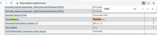

screenshot of spdx.org list of licenses featuring only UNLICENSE
What's the real difference between them? Is there any source where I can verifiably check if UNLICENSED means what it's supposed to mean?

Unfortunately, the format SPDX-License-Identifier: UNLICENSED is an invalid SPDX license expression per the SPDX spec, because the identifier UNLICENSED is not part of the SPDX license list. While well-intentioned, Solidity has here caused potentially dangerous confusion.
The SPDX project is concerned about machine-readable annotations for FOSS licenses (free/libre or open source software). By default, software is “all rights reserved”. For such software, it makes no sense to add an SPDX tag. Yet, the Solidity documentation is suggesting to refer to such all-rights reserved software as “unlicensed”.
The Unlicense is a license or license-like legal device that tries to do the very opposite of “all rights reserved”: it is a very permissive license that allows any use, and may even be equivalent to a public domain dedication that relinquishes any copyright. It's a bit confusingly written and has a confusing name so I don't recommend that anyone should use the license, but it's popular with people who don't like to think about licensing and want their software to be used however anyone wants, without limitations.
So Solidity's nonstandard UNLICENSED identifier is VERY DIFFERENT from the SPDX Unlicense identifier. See also Solidity issue #12251. Per SPDX-spec issue #49, it would have been better to represent unlicensed software with NONE, but that's not yet part of the formal SPDX license identifier syntax.
