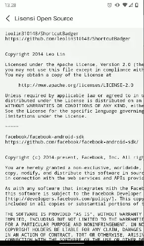

I've seen an app that did notices each license inside it so the user can read it easily. It did not not built with Cordova, but I mean it's an example of license noticing on mobile app.

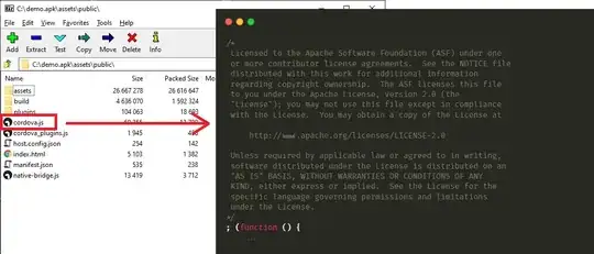

And Cordova is web-based. The packaged app will be include the source code. And the source code (cordova.js) is already notice the license on top of it. Even though we have to extract the packaged app.
So, my question is does the license comment count as license notices so I don't need to license notice again or I still have to make it like the app above?

You have shown an example of an app that has a “Licensi Open Source” screen, presumably accessible in the settings or another menu. This is the normal approach for including third party notices in an app. If you also have such a screen and include the Apache License and the Cordova NOTICE file, that would satisfy the Cordova license.
Do license headers in source files count as license notices? It depends:
  • yes, if distributing the actual source code.
  • no, they do not satisfy the Apache license notice requirements when distributing non-source forms.
But note: even though the cordova.js file is JavaScript, it is not the complete Cordova-JS source code. Your cordova.js file is likely a minified and bundled version of Cordova. For example, the file you've screenshotted clearly strips out comments when compared with the actual source code. The Apache License defines the Source as “the preferred form for making modifications, including but not limited to software source code, documentation source, and configuration files”.
