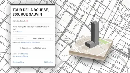

In answer to the original question, you should look at CityGML – this is a standardised format that's being heavily used by cities, particularly in Europe. It handles model definition, textures, various feature types (buildings, bridges, street furniture, all sorts) and has been built to keep the data about buildings and other objects intact (eg. which part is the roof and which is the wall). In fact it has various levels of detail that can be used depending on your need, so you could even go as far as modelling the full interior of a building down to the fixtures and fittings.
Here's an example CityGML building at LOD2 (not the worst, not the best):
That building is actually within a new open building library that I'm creating with the guys at Mapzen that uses ViziCities (I'm the creator of ViziCities). We hope to release it publicly very soon.
Failing that – collada or OBJ or fairly well used by cities for sharing buildings.
