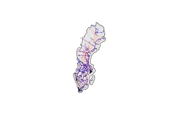

Open Infrastructure Map is based on OSM Data. Let's use it to create own map / dataset. In below example I'm using R and mainly osmdata together with sf packages.
Let's download the boundary of Sweden, which will be used as a clipping area.

Let's download all features with power key (for details, see https://wiki.openstreetmap.org/wiki/Key:power):
p <- osmdata::getbb("Sweden", featuretype = "country", format_out = "matrix") |>
  osmdata::opq(timeout = 600) |>
  osmdata::add_osm_feature(key = "power") |>
  osmdata::osmdata_sf()
Now, we will extract only power lines, which spatially belong to Sweden. They are in osm_lines data:
grid <- p$osm_lines |>
  subset(apply(sf::st_intersects(p$osm_lines, boundary, sparse = TRUE), 1, any)) |>
  subset(power == "line") |>
  subset(select = c("osm_id", "voltage")) |>
  tidyr::separate_rows(voltage) |>
  dplyr::distinct(.keep_all = TRUE) |>
  dplyr::mutate(voltage = as.numeric(voltage))
And let's add them to the plot:
plot(grid["voltage"], add = TRUE)
Let's extract the substations form osm_polygon and osm_multipolygon data, bind them together and add to plot as well:
subst <- p$osm_polygons |>
  subset(apply(sf::st_intersects(p$osm_polygons, boundary, sparse = TRUE), 1, any)) |>
  subset(power == "substation") |>
  subset(select = c("osm_id", "name"))
subst <- p$osm_multipolygons |> subset(apply(sf::st_intersects(p$osm_multipolygons, boundary, sparse = TRUE), 1, any)) |> subset(power == "substation") |> subset(select = c("osm_id", "name")) |> rbind(subst)
subst |> sf::st_geometry() |> plot(col = "grey90", add = TRUE)
The downloaded data can be saved on disc for further use with st_write() function from sf package. Then you can open it in QGIS and style it properly.
