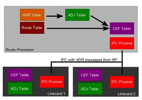

Conceptually, you can break the information flow into a control-plane and data plane, even within the router chassis. It seems that most of your confusion revolves around how the control plane works... this is a quick diagram I hacked up to illustrate...
IPC and CEF
  • The Route Processor builds the CEF table from layer-2 adjacency information (including ethernet, ppp, sonet, etc...) as well as all preferred routes
  • The entire CEF and adjacency table information is packed into IPC messages, which are sent between the Route Processor and all linecards. Individual CEF entries are rendered as XDRs within the IPC message. An XDR is just a Cisco-specific way of writing CEF entries into an IPC message.
  • Individual linecards unpack the XDRs from the IPC messages and build (what should be) an exact copy of the Route Processor's CEF and adjacency table on the linecard.
  • After the linecard completes revisions to the CEF and adjacency tables, a platform-specific process runs on the linecard to compute the data structures required for the platform's hardware to forward and rewrite packets on the linecard itself.
Synchronized IPC is pretty critical to dCEF's operation; if you don't keep messages synchronized between all linecards, you can wind up with prefix inconsistencies.
