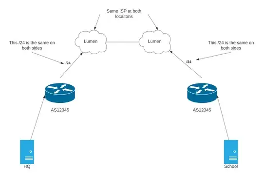

The setting: Two locations I'm trying to connect. I have a /24 address block from ARIN Both location have the Same ISP.
The Question:
  • Can I announce the same /24 address block at the HQ location to Lumen?
  • Can I announce the same /24 address block at the School location to Lumen?
Since /24 is the smallest I can announce. At the end of the day, I'm also trying to connect these two locations. Thanks in advance for any advise.
