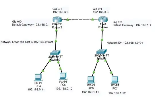

  2. When two routers are connected like this,
    "Router 2" has a connection to "Switch 0", which itself is connected to "PC4" and "PC5". "Router 4" has a connection to "Switch 1", which itself is connected to "PC6" and "PC7". "Router 2" and "Router 4" are connected to each other.
    Here PC4 is not able to ping PC6 or Router4 (192.168.3.3).
Why do we have to explicitly add entries for routing table in the second case when it was not needed in the first case?

    How do you expect R4 to know anything about networks on other routers? – Ricky Nov 12 '21 at 16:39
  • @Ricky Yes, your point is right. But Router4 is connected with 192.168.3.0/24 also, then why PC4 is not able to ping 192.168.3.3? – anonymous Nov 13 '21 at 17:42
    Because R4 does not know about 192.168.0.0/24. Run a few debug's; you'll see R4 receive the packet, but has no route to send the reply. – Ricky Nov 13 '21 at 18:38
  • @Ricky Sorry but I made a mistake in the previoous comment, I was asking that Router2 is connected with 192.168.3.0/24, then why PC4 is not able to ping 192.168.3.3/24? – anonymous Nov 14 '21 at 07:42
  • Asking the simple/dumb questions: are you sure it's only a router or did you accidentally grab a router/switch combo? (Totally not speaking from my own experience with packet-tracer or so... Not at all...)
    Ps, I'm surprised that username wasn't taken yet, nice one ;)
    – Daniël van den Berg Nov 14 '21 at 08:22
    How many times do I have to say it? 3.3 cannot answer 0.11 because it has no route to 0 The packet from 0.11 will get to 3.3, but it can't respond. – Ricky Nov 14 '21 at 13:31
  • @Ricky Thank you for your help. Now I understood your point (because of the last comment). It's crystal clear now!! – anonymous Nov 14 '21 at 14:26
  • @anonymous What network ID is the top network that connects the two routers together? – user253751 Nov 15 '21 at 10:14
  • @user253751 192.168.3.0/24 – anonymous Nov 21 '21 at 08:18

You don't have to add anything in the 1st case because it's automatic. As there's only one router, it obviously knows everything directly connected to it. When that becomes more than one router, some process needs to be in place to tell the others what isn't local. (either static routes, or any number of dynamic routing protocols.)
Thanks to Comments on this question by @Ricky; I'm editing this answer to clear the point. In the 1st case, there is only one router; it knows about both networks (192.168.0.0/24 and 10.0.0.0/8)
But In the 2nd case, there are three networks (192.168.0.0/24, 192.168.1.0/24, and 192.168.3.0/24) If PC4 tries to ping 192.168.3.3/24, packets from 192.168.0.11/24 will get to 192.168.3.3/24, but R4 cannot route back to 192.168.0.0/24. So That's why PC4 will be able to ping 192.168.3.2/24 but not 192.168.3.3/24.

In the second setup there are 3 ip-subnets involved:
192.168.0.0/24, 192.168.1.0/24 and 192.168.3.0/24.
Router2 knows about 192.168.0.0/24 and 192.168.3.0/24 because it has a interface in each. Router4 knows about 192.168.1.0/24 and 192.168.3.0/24 because it has a interface in each.
But there is nothing to tie them together so that Router2 knows were to send packets intended for 192.168.1.0/24 (and similarly Router4 has the same problem with 192.168.0.0/24).
So on Router2 you have to define a static route for 192.168.1.0/24 that points to 192.168.3.3. That will forward any packets for 192.168.1.0/24 to Router4 and Router4 knows what to do with those.
(And on Router4 you need to setup a static route for 192.168.0.0/24 via 192.168.3.2.)
The alternative is to setup a dynamic routing protocol (e.g RIP, IGRP, BGP, OSPF) on both routers that lets them learn the whole ip-subnet topology.
These can be quite complicated to configure except for RIP. RIP is by far the easiest to setup (just enable it, no config neccessary), but it is quite outdated and doesn't perform well in large (many subnets/routers) deployments. For a small network like this it would do just fine.
Tonny
  • 181
  • Router2 knows about 192.168.0.0/24 and 192.168.3.0/24 Then why PC4 is not able to ping 192.168.3.3 – anonymous Nov 13 '21 at 17:37
  • @developer Did you actually ENABLE routing on Router2? Because some routers (and Layer3 capable switches) don't do that automatically. Especially Cisco devices tend to default to "routing = off". That has given me a couple of WTF moments in the past, because it is the last thing you expect on a router, that you have to explicitly tell it to do its job. – Tonny Nov 13 '21 at 18:28
  • Yes, I have enabled routing on R2. If I just add routing table for R2, it will start working, PC4 will be able to ping 192.168.3.3, but that's not the point here for me, because If PC4 can ping 192.168.3.2 (without adding Routing table), It should be able to ping 192.168.3.3 also, because they are both in the same network. but that's not the case here. – anonymous Nov 14 '21 at 08:05
  • @anonymous Wait a sec. Has Router4 a route (for 192.168.0.0/24) or default gateway set to Router2 when the PC is unable to ping 192.168.3.3? If not that would explain it. The ping would have reached 192.168.3.3 (because Router2 can figure that much out on its own) but Router4 can't respond because it doesn't know the path back to the originating ip-address. – Tonny Nov 14 '21 at 10:44

The point is that each node needs to have a route to all the subnets, either a default route (hosts) or a specific route to each subnet (routers).
When a node is directly attached to a subnet, a specific route is set up automatically. Otherwise it needs to be set manually by the admin, or learned via a routing protocol from peer gateways. (Hosts often have a default gateway set by DHCP.)
Case 1 is trivial - likely the hosts have their default gateway set to their router's southward interface. That single router is directly attached to all subnets, so all necessary routing table entries are added automatically.
In case 2, hosts are likely using their router interface as default gateway as well. But unless you've explicitly set up the routers, they don't know the subnet behind the other router. Each router has got an automatic entry for the directly attached subnets - the client subnet below and the link to the other router. However, there's no route to the subnet behind the neighbor router, so that is unreachable.
You could set up each router on the other one as default gateway, but that would prevent any more routers to be added.
Much better, you either set up a static route to the remote network or you set up a routing protocol like OSPF between the routers.
