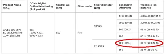

From the J9150D datasheet you linked, the max transmission distance over an OM1 fiber is 33m.
Thus you need other transceivers, or to change the fiber.

  • The transceiver is fine - OP said they weren't sure if the fibre between sites was OM1 or OM3. It's likely OM1/2 and, if so, it's the fibre that will likely need to change. – J... Apr 27 '20 at 20:18
  • It if was OM2 it would not change much the issue, the max transmission distance over OM2 for those transceiver being 82m. But yes, changing the fiber is probably the way to go. – JFL Apr 27 '20 at 21:17
