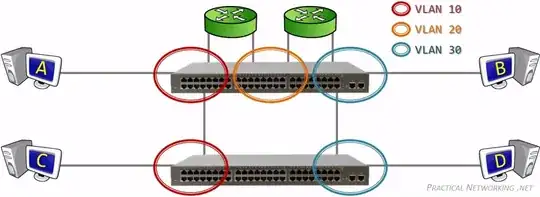

Let's talk about it using this topology of three networks (red / orange / blue):
A Router's primary function is to facilitate communication between IP networks. Which means if A wants to speak to D or B, the Router must be used.
However, a Broadcast by definition is a message intended to be sent to everyone within the sender's local network.
If Host A send a broadcast, then Host A means for the packet to only be delivered to Host C, and the Router on the left -- and no one else. The Router, by definition, does not need to, and should not, forward that broadcast anywhere.
So it isn't so much that the Router is "breaking" the Broadcast domain as much as it is that the Router is the natural boundary for the Broadcast domain. It is analogous to a wall being the natural boundary of a room.
If a Router is merely "switching" between it's interfaces and not actually routing, then you can safely consider that router as behaving like a Switch -- who's primary purpose is to facilitate communication WITHIN networks. As such, a Switch will not limit a Broadcast in any way, and in fact will help it along by flooding the broadcast out every port.
Edit: forgot your VLANs question:
And HOW exactly do Vlans break broadcast domains? If vlans abstract the underlying switch and logically divide it- say, in half, why would the resulting vlans break the broadcast domain? Even if they are perceived as different switches, don't interconnected switches forward broadcasts? How does it all work here ?
VLAN's simply break up one switch into multiple "virtual" switches. That image above with the three "switches" can also be represented as two physical switches with three VLANs:
In fact, you could consider this image the "Physical Topology" and the image above it as the "Logical Topology". They are essentially the same topology.
In this image, if the switches receive traffic (to include broadcasts) on VLAN 10 ports, they will only send that traffic out other VLAN 10 ports -- this is by definition of what VLANs do.
So whether there is only 1 switch or many switches in a row, Switches still only facilitate communication WITHIN networks, meaning across any number of switches you still have a single IP network.

  • In the rooms analogy for networks, a router might be a door or a hallway moreso than a wall. Perhaps buildings / roads / intersections would be another analogy, with routers obviously being intersections / interchanges. (Your point was clear and that was a good analogy, but router = wall caused some cognitive dissonance.) – Peter Cordes Apr 23 '20 at 13:11
  • Could you slightly elaborate, if the switches in your second image implement different VLANS, will the packet actually go from A to D, or is some VLAN configuration also needed, like IP routing configuration in routers? If the VLANS isolate segments, why does the packet actually go all the way through 3 VLANS? – Gnudiff Apr 24 '20 at 06:29
  • @Grudiff In the image, the routers are external to the switches (the router symbols above the upper switch). Of course, routing configuration is needed in the routers - that's what makes them routers. Specifically, the left router must know that VLAN 30 (with ips in 192.168.30.0/24 perhaps) is reachable via the right router (which is perhaps know as 192.168.20.2 in VLAN20). To add confusion, switches may allow to do the routing by themselves (which technically turns them into routers, just like bridging mode can turn a router into a switch) – Hagen von Eitzen Apr 24 '20 at 11:18

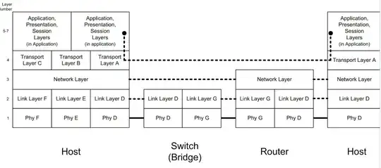

I've taken the liberty f including this image from TCP/IP illustrated, vol.1. Network Nodes and the protocols they implement
As shown above, end systems (hosts) implement the whole protocol stack, up to the application layer, while switches implement up to (and including) layer2 -datalink, while routers up to (and including) layer3.
Routers and switches as abstractions
Now, someone might point out that there are so-called layer-3 switches, for example. The answer to this is that 'router' and 'switch' are best thought of as abstractions rather than specific networking equipment.
What I mean by that is that a router is identified by the function it performs - routing and forwarding at layer3 - rather than the physical device that normally represents a router. To elaborate on this (or otherwise I might only muddy the water), a router running OpenWrt, for example, is quite obviously not limited in its protocol implementation to layer3, as it can run most of what a Linux end system typicallly can.
Additionally, all routers will typically have a Web Interface, which means they run a web server, which entails the transport and the application layers. Switches will sometimes have a Web UI too.
But this is misleading. Although Switches and Routers might implement the transport and application layers, they have nothing to do with their roles : switching and routing, respectively. These are just for management purposes and whatnot - this is what I mean by looking at switches and routers as functional abstractions. An end system can do IP forwarding and routing - and in that case, even though it IS an end system, it ACTS like a router - it performs the FUNCTION of a router.
