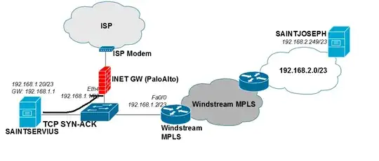

Following up on our chat discussion, the exact problem is that SAINTJOSEPH's TCP SYN packets are delivered correctly; however, stateful inspection on your PaloAlto firewall drops SAINTSERVIUS' TCP SYN-ACK response, due to asymmetric routing in your environment. This is illustrated in the two following diagrams.
TCP SYN from SAINTJOSEPH to SAINTSERVIUS:
sspx_Before02
Your PaloAlto firewall drops the TCP SYN-ACK from SAINTSERVIUS to SAINTJOSEPH:
sspx_Before03
This tracert makes it very clear that SAINTSERVIUS defaults through 192.168.1.1 (the PaloAlto firewall):

You should only have a single router next-hop for every subnet; however, you currently have two. This results in the drops shown in your wireshark screen capture (which indicates that TCP SYN-ACK packets never reach Windstream's MPLS network).
These are two long-term solutions which we discussed... I'm also including the quick hack we did to validate that the problem is stateful packet drops on the PaloAltos. I am assuming you are using multiple interfaces on the PaloAlto.

Suboptimal Workaround, Option C (what you used after our chat)
Open a cmd.exe window and add this route on SAINTSERVIUS as the Administrator:
route ADD 192.168.2.0 MASK 255.255.254.0 192.168.1.2
