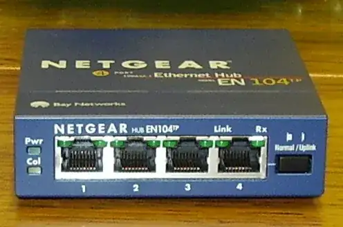

Since that caused a problem when you tried to connect switch or hubs with each other, many models included a port that could be switched between normal MDI-X and MDI "uplink" pinout:

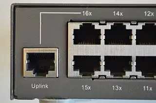

Some other devices featured a special port with two connectors, one for the "uplink" function:
