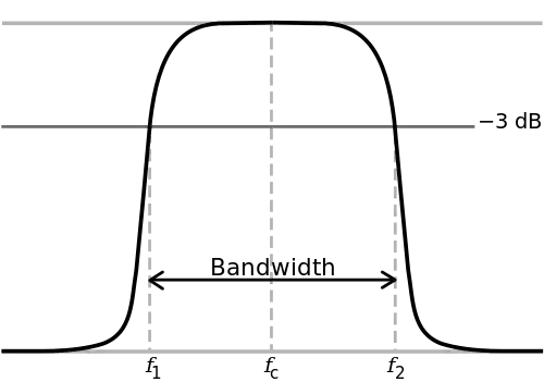

When talking about bandwidth in channels, we actually talk about passband bandwidth which describes the range of frequencies a channel can carry with little distortion. Say I have a channel that can only pass signals whose frequency is between f1 and f2. Its frequency response function (the channel's reaction to signals of different frequencies) might be something like this:
bandwidth
The bandwidth of a channel depends on the physical properties of the channel, so a copper wire will have a different bandwidth from a wireless channel and from an optical fiber. Here, for example, is a table from wikipedia, specifying the bandwidths of different twisted pair cables.
If our example channel has a bandwidth of 1Mhz, then we can fairly easily use it to send a signal whose bandwidth is 1Mhz or less. Signals with a wider bandwidth will be distorted when passing through, possibly making them unintelligible.
