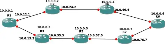

Preface; In the below topology R1 and R6 are PEs, all others are P routers, all routers are running c7200-jk9s-mz.124-13b.bin. At this point IGP is fully converged (OSPF with all interfaces in area 0 for simplicity) and MPLS is enabled on all interfaces using LDP. No BGP configuration exists at this point.
Here is the MPLS forwarding table on R1;
R1#show mpls forwarding-table
Local  Outgoing    Prefix            Bytes tag  Outgoing   Next Hop
tag    tag or VC   or Tunnel Id      switched   interface
16     Pop tag     10.0.0.2/32       0          Fa0/0      10.0.12.2
17     Pop tag     10.0.0.3/32       0          Fa0/1      10.0.13.3
18     Pop tag     10.0.24.0/24      0          Fa0/0      10.0.12.2
19     Pop tag     10.0.35.0/24      0          Fa0/1      10.0.13.3
20     20          10.0.57.0/24      0          Fa0/1      10.0.13.3
21     20          10.0.46.0/24      0          Fa0/0      10.0.12.2
22     21          10.0.76.0/24      0          Fa0/1      10.0.13.3
       21          10.0.76.0/24      0          Fa0/0      10.0.12.2
23     23          10.0.0.4/32       0          Fa0/0      10.0.12.2
24     24          10.0.0.5/32       0          Fa0/1      10.0.13.3
25     25          10.0.0.6/32       0          Fa0/0      10.0.12.2
26     26          10.0.0.7/32       0          Fa0/1      10.0.13.3
If my understanding is correct, R1 has generated labels for each FEC and R2 and R3 send R1 their LDP bindings (each MPLS label) for every MPLS FEC they have. Using this information R1 (for example) performs a lookup for traffic towards 10.0.0.6 and PUSHes the outgoing tag 25 before sending the the MPLS tagged packet towards 10.0.12.2 (R2).
A few questions arise here for me;
  1. After the initial convergence of the network, LSPs now exist between all FECs which are typically interfaces on LERs that connect to a subnet. R1 is a LER for an LSP towards R6 which is the other LER in that LSP. If R7 were also a PE router for example an LSP would exist between each R1 interface and each R7 interface and so more LSPs would exist then with R1 and R7 being the two LERs for those LSPs. Is that all correct?
  2. Assuming that baseline is correct; How does R1 know it is an LER for an LSP that spans to R6 for example (and all other possible LSPs that exist in this topology where R1 is one end device of the LSP such as if we introduced R7 as a PE as before?). Is this because the IGP (OSPF in this case) has full visibility of the network so it (all the edges) can be calculated from the IGP database?
  3. If 2 is correct, how did we get to that stage? Once the network is fully converged with IGP and LDP exchanges are completed, does a PE router then look through the FIB (or is it IGP RIB?) and work out all possible LDPs and which ones it would be an LER for, and who/what is the LER for the other end?

First, I would recommend checking out Cisco's MPLS FAQ For Beginners, or the NANOG Presentation "MPLS for Dummies" by Richard A Steenbergen. They both have some really good information.
With that said, let me address your questions one at a time. (I have excerpted them in part below.)
1: After the initial convergence of the network, LSPs now exist between all FECs which are typically interfaces on LERs that connect to a subnet.
Yes, LSP's exist towards all reachable FECs. And an MPLS packet could now be switched across the network.
2: Assuming that baseline is correct; How does R1 know it is an LER for an LSP that spans to R6 for example
R1 has no clue that it is part of an LSP that spans to R6. It only cares about the local/connected labels and FECs. That is part of what makes MPLS Label Switching fast and effective. It doesn't have to know the whole path. The router just knows that to reach FEC1, I apply label 1234, and exit interface XYZ.
Then later hops in the path utilize the same process, swapping in the appropriate next hop label and switching the packet on.
As for the bottom line question How are the LERs determined?, a router itself doesn't really know or care if it's an LER. It just knows that when it receives a packet destined for a local destination, with no tag, it delivers it.
In your output above, you can see that the first 4 outgoing FECs have Pop tag listed as the Outgoing Tag. A packet leaving R1 for one of the local subnets on R2 or R3 simply has it's tag popped and forwarded out the appropriate interface.
When R2 or R3 receive that packet, they see no label and process it via the normal routing process which delivers it to a local interface.
To quote the Wikipedia article on MPLS:
At the egress router, when the last label has been popped, only the payload remains. This can be an IP packet, or any of a number of other kinds of payload packet. The egress router must therefore have routing information for the packet's payload, since it must forward it without the help of label lookup tables. An MPLS transit router has no such requirement.
Brett Lykins
  • 8,278
  • 36
  • 66
  • I am also still relatively inexperienced at the inner workings of MPLS, so if I am incorrect in any particular, I welcome someone to please let me know! – Brett Lykins Jan 09 '14 at 01:41
    Brett, while you make some fair points, one major gripe is your LSP definition. The NANOG presentation you quoted doesn't define them the same way that IETF does in RFC 3031 Section 3.15; note that RFC3031 permits LDP LSPs, and does not require an LSP to have a label stack depth greater than 1. In other words, an OSPFv2 network with all nodes in Area 0, which also runs LDP will build unique LSPs for every route in the IPv4 table. Also see RFC 5283 Section 4 for more evidence. – Mike Pennington Jan 09 '14 at 02:07
    @MikePennington Very true... I am used to thinking of LSPs as manually configured tunnels or more along the lines of RFC 4206 for traffic engineering. I need to mull this over and take a stab at editing my answer appropriately. Thanks for the info. – Brett Lykins Jan 09 '14 at 02:33
  • The edit is better, my only other quibble is that the tail end of mpls vpn lsps still have the vpn label... – Mike Pennington Jan 09 '14 at 05:32
  • Brett Lykins, Mike Pennington; Thanks for the info. This is not fitting with what aseaudi has said in their answer though. They have suggested that LSPs only exist when I configure MP-BGP with VPNv4 neighbours. Is that correct, or is it that LSPs do exist to all FECs in my LFIB table on a local router such as R1 in the diagram above, but then once VPNv4 peerings are configure in MP-BGP additional LSPs come into existence between all VPNV4 configured neighbours for use with the MPLS VPNs? – Baldrick Jan 09 '14 at 10:23
    @jwbensley, "LSPs do exist to all FECs", and "MP-BGP VPNv4 binds new Level-2 LSPs per-prefix, per-VRF". aseaudi got three downvotes for good reason. I just wish people would observe downvotes, and quit upvoting unless they truly understood whether the answer is correct – Mike Pennington Jan 09 '14 at 11:07
  • jwbensley, i did not say that LSPs are created only with BGP, i said that you have a full mesh of LSPs in your diagram with no PEs yet defined. Then, MP-BGP creates another level of LSP over the full-mesh of LSPs you have above. The 1st level of LSP is being switched by the P MPLS LSRs routers, the 2nd LSP is used to switch to the correct customer vpn on the egress PE. Another way to manually create LSPs is to create PsuedoWires and MPLS Traffic engineering. I recommend reading Cisco Press MPLS Fundamentals book – aseaudi Jan 09 '14 at 11:11
    @aseaudi, you said nothing about a full mesh of LSPs. You said a "full mesh any-to-any MPLS Network" (whatever that is supposed to be). Then you sprinted into some discussion about MP-BGP, in spite of the fact that the question says "No BGP configuration exists at this point". You did not respond to the questions directly, you gave him a vague hand-waving answer. I proudly own one of those downvotes and will continue down-voting answers of this quality – Mike Pennington Jan 09 '14 at 11:25
  • The question is saying R1 and R6 are PE, even though no BGP or VPN or AToM PW is configured. This is important concept to be noted. – aseaudi Jan 09 '14 at 11:26
    This is why explaining downvotes is rarely useful. When confronted with their misconceptions, most people rationalize. – Mike Pennington Jan 09 '14 at 11:29
  • @MikePennington I was just addressing the current sample configuration, where there is no VPN, no BGP, etc. I can look at editing in info on what happens at the end of an MPLS VPN LSP. – Brett Lykins Jan 09 '14 at 13:43
  • @BrettLykins, understood, LER is a term used used in both contexts (Level 1 and multi level LSPs) – Mike Pennington Jan 09 '14 at 13:47
