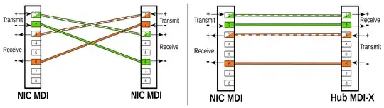

With twisted pair and a repeater hub, the hub is not much more than a digital amplifier. For that it senses a carrier from an incoming signal on one port and switches all other ports to output mode. In this output mode, any additional incoming carrier is a collision. This triggers a jam signal to propagate the collision and make the sender stop transmitting.
This repeating method mimicks the behavior of the previous, shared media Ethernet variants (10BASE5 & 10BASE2) where repeater were only used as physical segment joints or line extenders. Of course you're correct: twisted pair is a full duplex medium on the wire level where a collision only happens on the upper physical layer and not on the wire itself.
A repeater cannot permit more than one sender at the same time. Multiple simultaneous transmissions would mix on the output ports and produce unintelligible noise. Likewise, any node in half-duplex mode assumes a shared medium, incapable of full-duplex transmission. Any carrier sensed while transmitting is a collision, causing the sender to back off. Whether the medium is full-duplex capable (fiber, twisted pair) or not (coax) doesn't matter.
