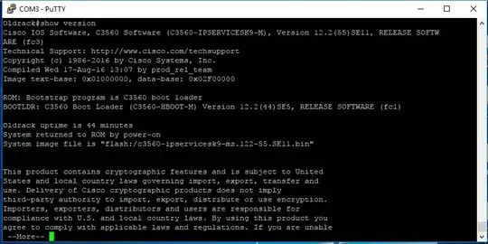

I am trying to connect "sfp-1ge-fe-e-t" sfp module to CISCO Catalyst C3560G-48TS switch.
When i pluged module to the port and following error was shown:
%GBIC_SECURITY_CRYPT-4-VN_DATA_CRC_ERROR: GBIC in port Gi0/49 has bad crc
Then I searched solution for the problem, so I found several solution that describes same steps.
like that: how to connect 3rd party sfp to the cisco switches
I tried following commands:
# service unsupported-transceiver
# no errdisable detect cause sfp-config-mismatch
# no errdisable detect cause gbic-invalid
But it didn't help actually. I couldn't turn on GBIC ports. It always shows "status down, protocol down".
Even show idprom interface gigabitEthernet 0/49 command doesn't show anything.
I have been experiencing with the proplem for two days.
Which steps should i follow? what is the real solution? Thanks in advance
enter image description here enter image description here enter image description here enter image description here

  • There is nothing you can do about this. The 3rd party SFP has to be tagged for Cisco, otherwise it's a no go. –  Jul 25 '18 at 08:23
I'm afraid the real solution is to use either Cisco transceivers or third-party transceivers - from reputable vendors- that are specifically "tagged" to be used on Cisco switches.
Using random transceivers will only cause troubles and the time you will loose will vastly overcome the economy made on the hardware.

  • 64
  • I have tested Cisco SFP (sfp-10g-sr) module too, but it also could not turn the port on the it showed following error: %PHY-4-SFP_NOT_SUPPORTED: The SFP in Gi0/51 is not supported – Simral Abdurahim 26 mins ago
    Even I have changed IOS, but it also doesn't work
    – Simral Abdurahim Jul 26 '18 at 08:15
