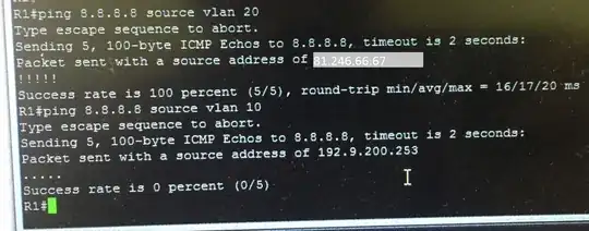

I need to put a Cisco router behind an ISP router. (The ISP doesn't allow us to use their modem only.)
I've called the ISP technical service and they've set up the connection with me. Their router will be used as a gateway for the Cisco router. I configured vlan20 with the correct IP address and linked it to Ge0, which is connected to the ISP router. I can ping the internet from that VLAN.
I also created vlan10 for the internal network, which will be connected to Ge1. From that vlan, I'm not able to ping the internet.
I tried to configure a gateway of last resort but that didn't work.
Below is an overview of the setup/configuration: enter image description here
interface GigabitEthernet0
 switchport access vlan 20
 no ip address
interface GigabitEthernet1
 switchport access vlan 10
 no ip address
interface Vlan10
 ip address 192.9.200.253 255.255.255.0
 ip nat inside
 ip virtual-reassembly in
 ip tcp adjust-mss 1412
interface Vlan20
 ip address 81.246.66.67 255.255.255.
ip route 0.0.0.0 0.0.0.0 81.246.66.66
I thought it would work with that route to the ISP router, but it seems it doesn't work: enter image description here Could anyone provide me some help with this?
Edit: full config as requested: Only hidden some passwords and changed the public IP's.

Update: It's working now, the fault was misconfiguration of NAT indeed. This is the extra configuration I've done:
ip nat inside source list nat-list interface Vlan20 overload
ip nat inside source static tcp 192.9.200.90 25 81.246.66.67 25 extendable
ip nat inside source static tcp 192.9.200.175 80 81.246.66.67 80 extendable
ip nat inside source static tcp 192.9.200.90 110 81.246.66.67 110 extendable
ip nat inside source static tcp 192.9.200.90 81.246.66.67 143 extendable
ip nat inside source static udp 192.9.200.90 81.246.66.67 143 extendable
ip nat inside source static tcp 192.9.200.90 25 81.246.66.67 587 extendable
ip nat inside source static tcp 192.9.200.94 6666 81.246.66.67 3389 extendable
ip nat inside source static tcp 192.9.200.90 80 81.246.66.68 80 extendable

You don't have NAT enabled (you don't have ip nat outside on Vl 20).
Without NAT, the ISP doesn't know how to route back to your 192.9.200.0 network. If you NAT to the VLan 20 address, the ISP will be able to route back to you.

The problem is that you have not defined the ACL that tells the router which addresses to translate.
You have:
ip nat inside source list nat-list interface GigabitEthernet2 overload
but you do not have the nat-list configured. You need something like:
access-list nat-list permit 10.10.10.0 0.0.0.127
access-list nat-list permit 192.9.200.0 0.0.0.255
-or-
use the ACL (23) you did define for NAT:
ip nat inside source list 23 interface GigabitEthernet2 overload
-and-
As Ron Trunk pointed out, place the ip nat outside command on the WAN interface.

  • Thanks, it indeed makes sense to configure NAT. I'll try it later and let you know if it worked. – RobbeM Jul 17 '18 at 13:03
  • I'm preparing the modifications and already have this question. If I use ACL 23 for NAT, which permits anything in 192.9.200.0/24. Will the other static NAT rules that I already configured still work? Or do i need to explicitly deny them in the ACL? – RobbeM Jul 17 '18 at 13:16
  • Those rules should work; they are for NAT the other way. Basically, they are static NAT table entries, but sourcing traffic from inside will create dynamic NAT table entries. – Ron Maupin Jul 17 '18 at 14:13
Your requirement is quit simple but your configuration is missing NAT overload rule . Which is used to translate private ip address to public ip address , All internet outbound traffic will use this NAT translation configuration
Router(config)# access-list 10 permit ip 192.9.200.0 255.25&.255.0 Any Router(config) # ip nat inside source list 10 interface Ge0 0verlaod
