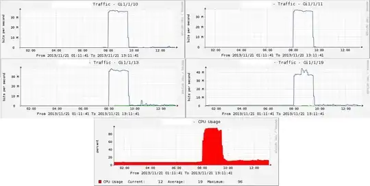

And a little collection of graphs to illustrate the impact:
CPU Spike Graph

I am somewhere that blocks Dropbox downloads, so I can't see the captured traffic, but I'll go on the assumption these were 64-byte ethernet multicasts.
Let's do some math to see how much traffic you're permitting...
A 64-byte frame is 672 bits (including 8 bytes for Preamble/SFD, and 12 bytes for IFG)...
8*(8 + 12 + 64) = 672 bits
That means line rate Gigabit Ethernet 64-bytes frames is about 1.488Mpps...
(1000000000 / 672.0) = 1488095.24 pps
What does this mean to you? Well your current storm-control configuration throttles traffic at 5% of line-rate, so you're allowing 74.4kpps of traffic to hit your switch before storm-control kicks in. 74.4kpps * 64-byte frames is 38Mbps, which is right at what your graphs show:
Answer
So, the bottom line is that you're allowing too much traffic to hit the switch CPU, which is why the CPU utilization was high. 74.4kpps is really too much to allow any switch CPU to process.
