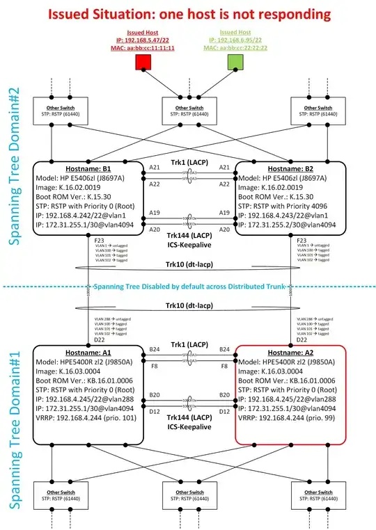

I've recently faced a problem in an HPE Distributed-Trunking Switch-to-Switch Square-Topology.
Diagram of normal situation with both hosts working
Image 1 (shows the essential part of the architecture that consists of 4 switches working in pairs, being switch A1 and A2 the first pair, B1 and B2 the second pair. Both pairs connect switches, servers, clients (not fully drawn for ease of reading).
During normal operations A1, A2, B1 and B2 can ping both 192.168.5.47 and 192.168.6.95 that are used here as "test" hosts.
Sometimes it happens that one of the two hosts gets unreachable ONLY FROM A2, like described in Image 2.
Diagram of issue with one host not responding
Normal operations are restored by issuing a clear mac-address Trk1 on switch A2.

I've noticed that the erred host (192.168.5.47) is seen by A2 on Trk1: it should be on Trk10 instead.
The only way to restore normal operation is by issuing clear mac-address Trk1 on switch A2.
Can someone figure out one or more possible reason for this behavior?

  • Is the STP priority of 0 for both A1 and A2 intentional? Additionally, could you post the hosts' MAC-port associations on A2 in working condition and when it's failing? – Zac67 Feb 19 '18 at 22:03
  • Good evening Zac, thank you for your reply. I double-checked and I can't find priority 0 for both A1 and A2... I've set 0 (root) on A1 and 1 on A2. Am I wrong? The hosts' MAC-Address for both A1 and A2 during working and failing conditions are reported above. It basically seems that the unreachable hosts' MAC addresses "go" outside Trunk10 and are seen on Trunk1. – Francesco Ruggeri Feb 23 '18 at 21:07
  • Well, the diagram above shows prio 0 for both A1 and A2. A2 is 1/4096 then just like B2? Also, I was asking which port the destination host's MAC address are associated with on A1 and A2 - I guess this changes from working to non-working. – Zac67 Mar 09 '18 at 21:35
  • Are you expecting 192.168.4.x to be on both vlan 1 and vlan 288? There might be additional vlan mismatches further out in the network causing weird mac learning. – cpt_fink Sep 21 '19 at 04:59
  • @Zac76. You're right, it's a typo. The diagram shows STP priority 0 for both A1 and A2 (wrong) but the attached configuration is correct with A1 in STP Prio 0 anfd A2 in STP prio 1. The STP bridge is normally A1. – Francesco Ruggeri Sep 30 '19 at 06:37
  • @cpt_fink. I expect 192.168.4.0/22 being managed in VLAN 1 throug switches B1 a B2 at the top of the diagram (and all their downstream connected switch, named "Other Switch", this part of the network was already operational when I added A1 and A2) and the same subnet being translated and managed in VLAN 288 at the "entrance" in switches A1 and/or A2. Ports D22 on A1 and A2 behave as normal access ports (to VLAN 288) for untagged traffic coming from B1 and/or B2. Of course the tagged portion of traffic (VLAN 101,...) is normally managed as tagged traffic with same VLANID on both ends. – Francesco Ruggeri Sep 30 '19 at 06:51
I've also encountered this problem two times allready. Unfortunaltely HPE support was not very helpfull. But my mac-learning problems always related to distributed trunking. My workaround was to step away from dt.
I recommend to use VSF if possible (V3 Modules and zl2 Switch required among other things: https://higherlogicdownload.s3.amazonaws.com/HPE/MigratedAttachments/E8DDA7C0-AFED-4DF4-B5C7-FD71B705C690-2-AOS-Switch_VSF_Configuration_Guide.pdf - Page 3)
I would treat your old 5406(J8697A) switches as separate units (delete dt), as they do not support VSF. STP would have to do the work here.
Even if this solution is not really practical, i can tell that you don't have the wrong configuration.
