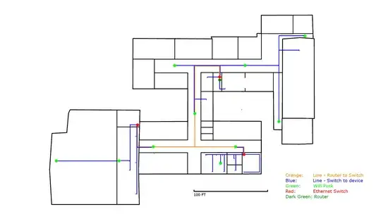

EDIT: I was asked to provide the layout of the building: Building Layout
The red points are all available to be used for networking. Unfortunately, from each individual point, the opposite end of the building is greater than 300ft away. The walls are also cinder block up to the ceiling, so running through walls is not an option. The picture shows what I had planned to wire.

    You are mixing two things here, there is no preferred design for wiring cat5e or cat6 cables, you should provide more information about the building – Mr.lock Mar 01 '17 at 05:28
    The only problem is if the cable distance from a WAO to the cross-connect in the TR is more than 90 meters, not that the distance from one end of the building to the other end is more than 100 meters. How far, by cable, including patch cords on each end, going up and down the walls, service loops at each end, etc.? if that is more than 100 meters from the device interface to the switch interface, then you have problems. – Ron Maupin Mar 01 '17 at 18:50
  • Running though walls wouldn't save much, anyway; but cinderblock to the ceiling is no problem - that's what masonry drill bits are for... A scale reference would still be helpful. – Ecnerwal Mar 01 '17 at 18:51
  • Thanks, added a scale for you. running from any point in the building to the opposite end is about 350 ft –  Mar 01 '17 at 19:07
    So a casual inspection of the diagram says everything is less than 100 meters of cable, most likely. If you are only going to light this at gigabit, you can stick to copper, which you are obviously more comfortable with, and reconsider fiber when 10 gig or higher speeds are on the table; if the 6A is installed correctly it should work at 10Gig, but it can be quite picky in a way that fiber isn't, and fiber is not limited to that speed, either. – Ecnerwal Mar 01 '17 at 19:38

Is it more or less than 100 meters of cable between each of the 3 switches? Is it more or less than 100 meters of cable from each device to the switch it connects to? "The far end of the building" is not a factor here, unless there's a cable you are trying to run from this switch to that end.
If more than 100 meters, you need fiber to make the link. If less, copper is an option, but fiber is a superior option. If you limit yourself to that particular switch model, 4 fibers (2 links, aggregated) from each remote switch to the switch at the router is all you're going to be able to manage. Use 12 fiber cable anyway, it's not much more expensive if you shop well. A different switch at the router might offer you 8 SFPs and aggregating 4 links to the other switches, but changing all three to a switch model that supports SFP+ would be 2.5 times better than that...

If cost is such a concern and your blue lines are fairly accurate, smaller switches might save quite a bit of money.

  • Thanks for the suggestion, I edited the post with more information. How would you recommend connecting the switches via fiber? (I posted the switch model in the original question) –  Mar 01 '17 at 18:18

  • Thank you for the suggestion! I updated the original question with more info. Although we would love to have someone come in and wire for us, that is far more of an investment than any of us are able to make. How would you recommend connecting the switches via fiber? I posted the switch model in the original question) –  Mar 01 '17 at 18:23
PoE, like ethernet, is limited 100 meters: 90 meters for solid-core horizontal cable, and a total of 10 meters of stranded patch cables. If the building is too large for PoE, it is too large for ethernet.
The proper solution is to build another TR (Telecommunications Room). You can use a fiber backbone cable to connect your two TRs, and run horizontal cableing from both, covering the building. You can add multiple TRs, if necessary.
