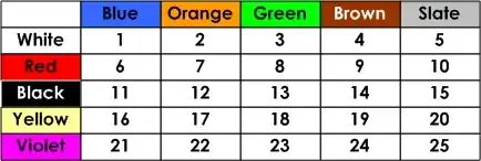

UTP cables used in the 586 standard inherited their color code from the 25 pair color code developed by AT&T for cabling used in telecommunication purposes.
The following table shows the combination of colors to be used for each pair
This gives us this set of combinations:
UTP cabling simply used the first four combinations.

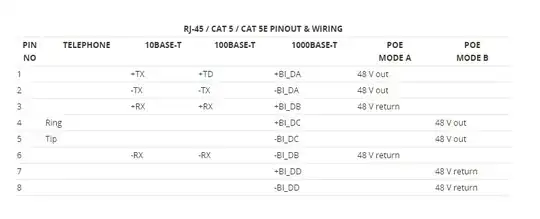

There are two valid standards for the Ethernet RJ45 pin out, 568A and 568B:
The 568A and 568B pin out standards
568A provides backwards compatibility when connecting two phone lines, 568B for only one phone line. 568B also offers a better prevention of cross talk (interference between the cable pairs).
You can use either 568A or 568B, but you HAVE to use the prescribed pairings of the pins:
1 paired with 2, 3 with 6, 4 with 5 and 7 with 8!
Assignments of the 8 RJ45 pins under different uses
You CANNOT pair pin 3 with pin 4 or pin 5 with pin 6!
Pins 4 and 5 in the middle of the connector ALWAYS have to be paired with one another!
Obviously you also have to use the exact same pairings and pin outs on both ends of any cable you manufacture!
